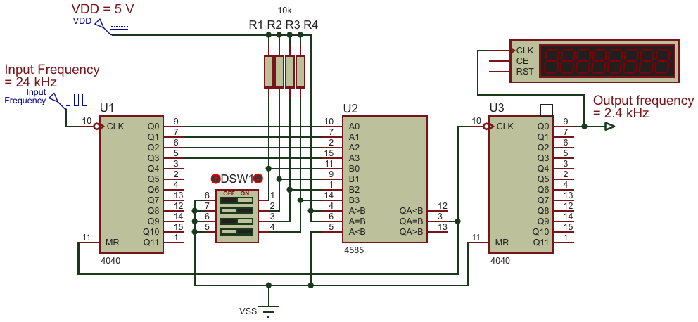

This circuit divides the input frequency by 10. The output is a 2.4 kHz square wave with a 50% duty cycle. The ICs' power supply and ground pins are not shown. For division by other numbers, change the DIP switch (DSW1) setting: OFF=1, ON=0

This circuit divides the input frequency by 10 The output is a 2.4 kHz square wave with a 50% duty cycle The ICs' power supply and ground pins are not shown For division by other numbers, change the DIP switch (DSW1) setting: OFF=1, ON=0
