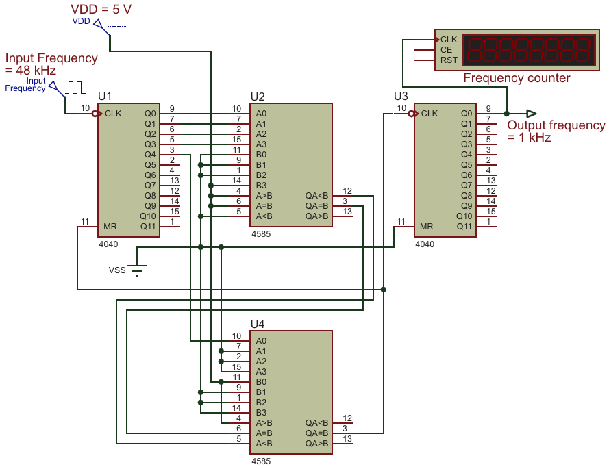

This circuit divides the input frequency by 48. The output is a 1 kHz square wave with a 50% duty cycle. It uses two 4585 comparators (U2 and U4) connected in cascade. Again, the ICs' power supply and ground pins are not shown. The same circuit can also b

DescriptionFigure 2
