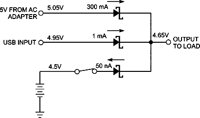

Many systems must select among two or more low-voltage dc-input sources, such as an ac adapter, a USB (Universal Serial Bus) port, or an onboard battery, for example. You can implement this selection using manual switches, but automatic switching is preferable. You usually want to use the highest-available input voltage to power your system. You can accomplish this task using a Schottky-diode ORing scheme (Figure 1). Unfortunately, the forward-voltage drop of a Schottky diode ranges from 300 to 600 mV. This voltage wastes power, creates heat, and decreases the voltage available to your system.
ottky-diode ORing can power a load from the highest input-voltage source.
Figure 1. Schottky-diode ORing can power a load from the highest input-voltage source.

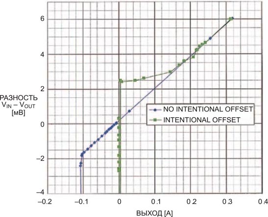

Figure 4 shows current-voltage test data for the operating region. The complete design, including intentional offset, produces the green curve. The equivalent of an unfavorable internal offset and no intentional external offset produces the blue curve. Although the green curve sacrifices some forward-voltage drop at light-load conditions, its forward voltage is always less than the full-load maximum. The intentional offset avoids any significant reverse current in the MOSFET. This design can switch at the 0A current transition, at which the leakage-current MOSFET’s drain-body diode is likely to dominate.

Figure 4. The green curve shows results with the correct external offset applied. The blue curve shows results when the op amp's internal offset is in the unfavorable direction and no external offset is applied.
On the other hand, the blue curve, without intentional offset, permits significant reverse current under some circumstances. This example shows approximately 100-mA reverse current with 2-mV reverse voltage across the MOSFET before the circuit switches off the MOSFET. Both the P- and the N-channel designs have undergone testing, and the P-channel design is in production.
