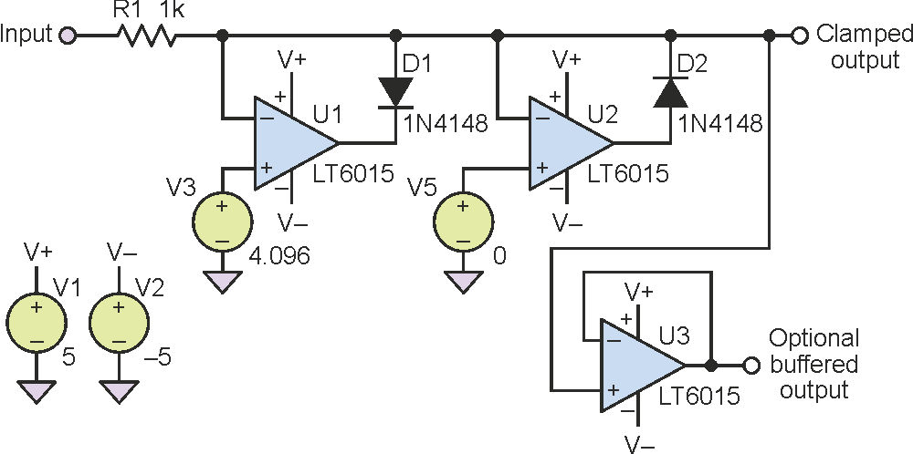

It can be a challenge to match the voltage range of an analog signal to the input range of an analog-to-digital converter (ADC). Exceeding the ADC’s input range will give an incorrect reading. And if the input goes far enough beyond the power-supply rails, substrate currents may flow into the ADC, which can then cause latch up or even damage to the part. However, restricting the input-voltage range to lower, more-conservative levels wastes the ADC’s dynamic range and resolution.
A simple op-amp clipper (Fig. 1) prevents these problems. The maximum allowable input voltage is applied to the non-inverting input of U1, and the output is fed back to the inverting input via small-signal diode D1. The ADC’s reference voltage can be used for the clipping reference if available. When the input voltage is below the reference, U1’s output is driven to the positive rail and D1 is reverse-biased, so the input signal passes through without being altered.
Op Amps Make Precision Clipper, Protect ADC
Figure 1. This clipping circuit uses a complementary pair of op amps to prevent excessive
positive (U1) and negative signal excursions (U2) of the input signal, to maximum
available signal dynamic range without damaging overload.
When the input goes above the clamp voltage, the op-amp output reverses and closes the loop through D1. As a result, it effectively becomes a unity-gain follower to the clamp voltage. Input resistor R1 limits the amount of current the op-amp output has to sink. A second op amp (U2) performs the complementary negative clipping function, preventing the signal from going below ground. Thus, in this example, the output signal is restricted to 4.096 V to 0 V out.
While simple in concept, this circuit poses unique challenges for the op amp. First, most modern op amps have back-to-back diodes across their input to prevent the application of large differential voltages to the inputs. This can cause damage to the part or shifts in the input offset voltage. In this circuit, these diodes would prevent the output signal from going more than one diode drop below the positive clamp voltage or one diode drop above the negative clamp voltage.
Deciding whether a given op amp has these diodes can require some detective work. Some parts’ datasheets show the presence of the input diodes, but others don’t. Another indication of the diodes’ presence is a limitation in the Absolute Maximum Ratings section of input current to a few milliamps.
In addition, the output of the op amp has to slew from the “unclamped” to the “clamped” state as quickly as possible in order to clamp a fast-rising signal without a potentially dangerous overshoot. Furthermore, rail-to-rail input and output operation of the op amp is desired so it can function with voltages close to the limits of the power supplies.
The LT6015 family of op amps, which includes the LT6016 dual and LT6017 quad versions, addresses these issues. Because there are no diodes on the inputs, they can have a very large differential voltage, which should not impose a limitation on any practical ADC application. Use of large differential voltages at the input allows the introduction of clamping and other nonlinear circuits. Furthermore, the input voltage can go as high as 80 V above or 25 V below the V– rail, which allows the part to survive inputs that would damage other parts.
The LT6015 is further unique in that it allows a power-supply range from V+ to V– of up to 60 V, which would allow use of the circuit to clamp higher voltages than the great majority of op amps. It also has a slew rate of 0.75 V/µs, which enables it to clamp reasonably fast-rising signals. The sub-100-µV typical offset voltage ensures that the clamping level is very accurate.

Another limitation on this circuit is that the output resistance is defined by R1, which needs to be at least a few hundred ohms to limit the output of current in the op-amp output. Since some ADCs need to be driven by a low resistance, buffer amp U3 might be required. Using the LT6017 quad-version package would permit a single part to perform all of these functions.
