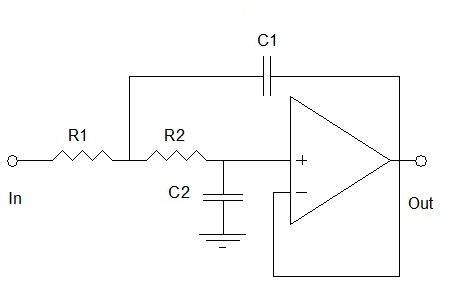

In the next stage of analog part we are going to add a filter. Since DDS signal generator is capable of outputting various types of signals we don’t want it to be hardwired. For instance if we generate sine wave the we could use filter to make it more smooth while on square wave it would have negative effect by rounding the shape. For this we can add a bypass switch that would allow to insert or bypass filter on demand. What filter are we going to use for this purpose. Since we have plenty of op-amps on TL074 we can make an active filter.
Optional filter stage - Butterworth (Sallen – Key) low pass filter
I find Butterworth (Sallen – Key) low pass filter quite handy since it gives flattest response in band. Lets select parameters for this filter. DDS generator in our case isn’t going to exceed 100kHz frequency. Also we want attenuation in this up to roll – off frequency close 0dB. So lets increase roll-off frequency up to 200kHz. This value we are going to use while calculating.
Resistor and capacitor values of filter can be determined with these simple rules:
R1 = R2, C1 = 2·C2
If we select R2 = R1 = 33k (have plenty of these)
then we can calculate C2 as follows:
so standard value of C1 = 33pF.
You can check calculations on line here.
