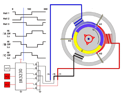

Most BLDC motors have three Hall sensors embedded into the stator on the non-driving end of the motor. Whenever the rotor magnetic poles pass near the Hall sensors, they give a high or low signal, indicating the N or S pole is passing near the sensors. Based on the combination of these three Hall sensor signals, the exact sequence of commutation can be determined. Figure shows the typical connection of the IR3230 to a 2-pole BLDC motor with Hall sensors. Based on the physical position of the Hall sensors, there are two versions of output. The Hall sensors may be at 60° or 120° phase shift to each other. This job is referred to a 60° phase shift configuration.

IR3230 typical connection to a BLDC motor with Hall effect sensors embedded in the stator
