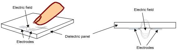

There is a sampling capacitor which stores the charges coming from the electrodes which form a coupling capacitor with less capacitance than the sample one. When a finger approaches, the dielectric (between the two electrodes) is modified and so the capacitance decreases. As a consequence, the time taken to load the sample capacitor will increase and this difference is used to detect if a finger is present or not.

Electric field between 2 surface electrodes
