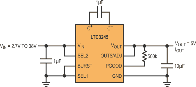

The LTC3245 is a buck-boost regulator that dispenses with the traditional inductor, and instead uses a capacitor charge pump. The LTC3245’s input voltage range is 2.7 V to 38 V, and it can be used without a feedback divider to produce one of two fixed output voltages, 3.3 V and 5 V, or programmed via a feedback divider to any output voltage from 2.5 V to 5.5 V (Figure 1). Maximum output current is 250 mA. As a result of its buck-boost topology, the LTC3245 is capable of regulating a voltage above or below the input voltage, allowing it to satisfy automobile cold crank requirements.
2.7 V to 38 V VIN Range, Low Noise, 250 mA Buck-Boost Charge Pump Converter
Figure 1. A 5 V output buck-boost converter.

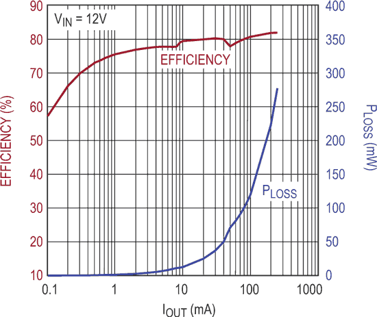

The LTC3245 achieves efficiency of 80% when delivering 5 V, 100 mA from a 12 V source, significantly higher efficiency than an LDO, making it possible to avoid the space and cost requirements of an LDO with a heat sink (Figure 2). The LTC3245 is available in an exposed pad MSOP12 or 3 mm × 4 mm DFN12.
Figure 2. Efficiency of the converter in Figure 1.

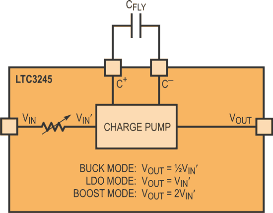

Figure 3 shows a simplified block diagram of the LTC3245 converter. Charge pumps can operate as N/M × VIN converter, where N and M are integers. ½, 1, and 2 are the simplest forms and only require one flying capacitor. Higher order N and M require more flying capacitors and switches.
Figure 3. Detail of the charge pump block.
Because N and M are integers, a straight charge pump cannot be used to produce an arbitrary output. Instead the controller modifies VIN to produce VIN’, which is then fed to the charge pump. The charge pump can operate in one of three modes, buck, LDO or boost, resulting in ½VIN’, VIN’ or 2VIN’, respectively.
By properly controlling both VIN and the operating mode of the charge pump any arbitrary voltage can be achieved. When operating in buck mode, the input current is approximately half that of an equivalent LDO, offering a significant efficiency improvement.

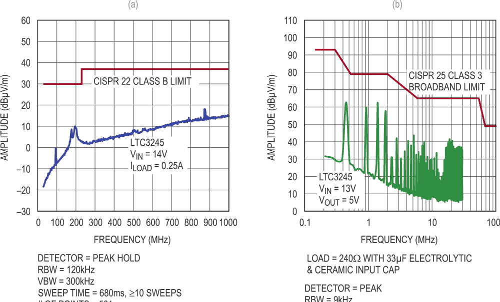

The LTC3245 can be optimized for light load efficiency or low output ripple by choosing high efficiency Burst Mode® operation or low noise mode. Burst Mode operation features low quiescent current and hence higher efficiency at low load currents. Low noise mode trades off light load efficiency for lower output ripple at light loads.
Figure 4 shows measured radiated and conducted signatures of the LTC3245, tested in a microchamber in accordance with CISPR25. As can be seen here, when properly decoupled, the LTC3245 does not present any issue when striving to meet government regulations for radiated or conducted emissions.
Figure 4. Radiated (a) and conducted (b) emissions.
