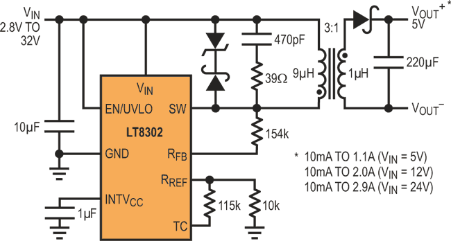

The LT8302 simplifies the design of an isolated flyback converter by sampling the isolated output voltage directly from the primary-side flyback waveform. This solution requires no third winding or opto-coupler for regulation. The output voltage is programmed with two external resistors and an optional third temperature-compensation resistor. By integrating loop compensation and soft-start, the device minimizes the number of required external components, as shown in Figure 1. Boundary mode operation allows the use of a modestly sized transformer, while maintaining excellent load regulation. Low ripple Burst Mode operation yields high efficiency at light load while minimizing the output voltage ripple.
Monolithic No-Opto Isolated Flyback Converter Provides Versatile Solution
Figure 1. Complete 5 V Isolated Flyback Converter for a 2.8 V~32 V Input.

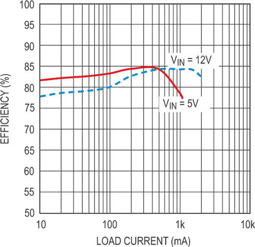

Figure 1 shows a complete LT8302 flyback schematic. This converter has up to 85% efficiency, as shown in Figure 2, and sustains 82% efficiency at a 10 mA load with a 5 V input, thanks to its low quiescent current.
Figure 2. Efficiency of the Flyback Converter in Figure 1.

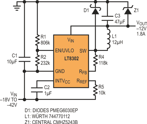

Negative Input Power Supplies
In a typical negative input power supply, the IC’s ground pin is connected to the negative input rail, which is a varying voltage. As a result, its output voltage changes with input voltage, assuming no level-shift circuitry. LT8302’s unique feedback sensing scheme can easily develop a regulated output voltage directly through switch node voltage waveform, eliminating the level-shift circuitry that would otherwise be required.
Figure 3.  Negative Input to Positive Output Buck-Boost Converter.
Figure 3 shows a simple negative-to-positive buck-boost converter, and Figure 4 shows a simple negativeto- negative buck converter.
Figure 4. Negative Input to Negative Output Buck Converter.
