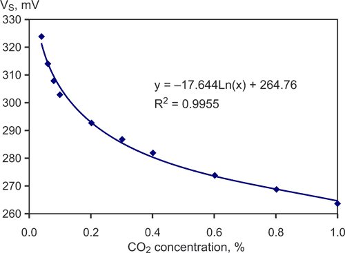

Figure 1. The sensor has a logarithmic response with a 265 mV offset.

The MG-811 sensor measures CO2 concentration from 400 to 10,000 ppm (0.04% to 1%). Figure 1 displays the transfer function of the sensor. The data points come from the datasheet of the MG-811. The line and equation are generated by the curve fitting tool of Microsoft Excel.

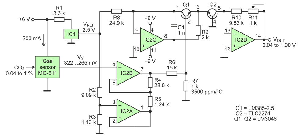

Figure 2. A quad op-amp and a pair of matched transistors provide
simple and cheap linearization. R7 is a standard
compensating resistor, as from PRC.
Figure 2 presents the circuit. It uses a quad op-amp and a pair of matched transistors. IC2A and IC2B, make a conditioning circuit that provides high input resistance to the sensor, removes the 265 mV offset from the sensor response, and amplifies the resulting signal. The goal is to modify the sensor response to the form VS = lnC (C is CO2 concentration) so the antilog converter (built with IC2C, IC2D, and the matched transistors, Reference 2) can implement the elnC = C identity, thus providing a linear relation between VOUT and CO2 concentration. The 2.5 V reference IC1 allows the circuit to work with other gas sensors – like the TGS4161 from Figaro – that require not 6 V, but a 5 V power supply. Note that the sensor draws a lot of current.

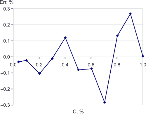

Figure 3. Accuracy is enough for a 3.5-digit panel meter.
The circuit needs only a full-scale adjustment (R11) for calibration. Accuracy is ±0.3% (see Figure 3), which matches well to a 3.5-digit panel meter, and is much better than the expected accuracy of this type of sensor.
