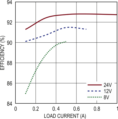

| Figure 3. | Efficiency of the 2-Stage Converter in Figure 2 [VIN 8 V to 24 V, VOUT 140 V]. |
This solution features an input voltage range from 3 V to 36 V, nominal 12 V. To decrease components’ thermal stress, the output current should be reduced when the input voltages falls below 10 V. Figure 3 shows measured efficiency, and Figure 4 shows the start-up waveforms. A 93% efficiency is shown with VIN = 24 V and with the 140 V output loaded from 0.4 A to 1 A. This converter can operate at full load with no airflow.
