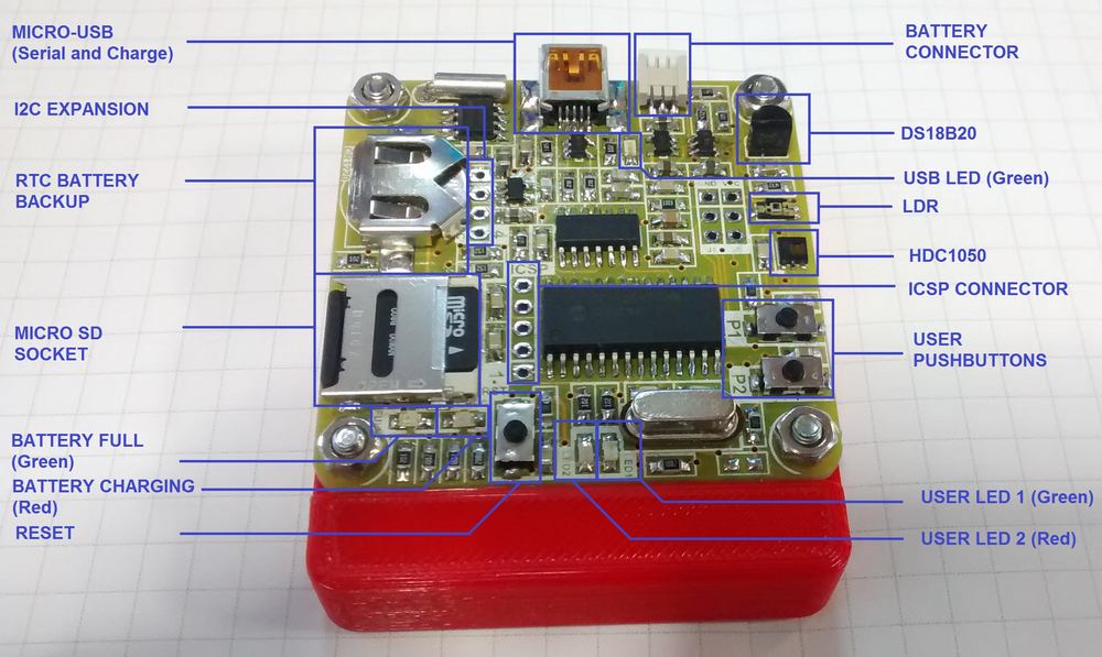

Hi all! I’m continuing here with the last board I design and now I’m continuing testing. It’s a battery-powered small datalogger based on a PIC18F2620 microcontroller (Figure 1). The idea comes a few months ago, talking with a friend. He needs something to  monitoring temperature and humidity inside a sea container, for a three weeks travel from Spain to China. Low consumption is important, in order to have maximum autonomy with a small battery. I use a HDC1050 temperature and humidity sensor, and a TEMT6000X01 ambient light sensor. The collected data is stored on a micro SD card. Also the board has a RTC for timestamp, a Li-Ion battery charger, user pushbuttons and leds, and a MCP2221 USB bridge to communicate with the board and configure some parameters through software. Let’s see the board in detail!
Portable temperature, humidity and light ambient datalogger.
Figure 1. Portable temperature, humidity and light ambient datalogger.
Hardware
First of all, here’s a view of the board with the main components (Figure 2). After I’ll talk about the case. I also let in the board the footprint for a DS18B20 temperature sensor. Originally, it’s on the board because I’m not sure if I’ll be able to solder the HDC1050 sensor, so if I can’t, at least I can obtain the temperature from this sensor.
