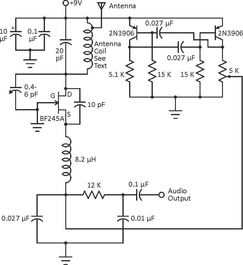

Adding an external oscillator to force the quenching of the circuit solves these problems. A two-transistor astable multivibrator is used for this quenching oscillator. This makes a three-transistor circuit – still quite simple for an FM radio (Figure 2). The adjustment of the quench-level control is critical, so a good single-turn potentiometer should be used in this position. The quench frequency of this oscillator is about 21 kHz.

Figure 2. The tuner with forced quenching.
The antenna coil is composed of five turns of space wound AWG 18 wire on a 1/4" form. The windings are spaced one wire-width apart, so you can close-wind two windings on the form and then remove one of them. When formed, the coil can be removed from the form. The coil is tapped one half turn from the 9 volt supply side to make a connection for the antenna. A one meter long wire antenna is sufficient. The 0.04 to 6 pF capacitor is used to tune in stations.
The tuner needs an audio power amplifier. The output level of the tuner is below line level, so an amplifier with a microphone input would be useful. A musical instrument amplifier would work fine due to the high gain guitar input. Another solution is to use the circuit [1]. This amplifier with a gain of ten will boost the output to audio line level.
