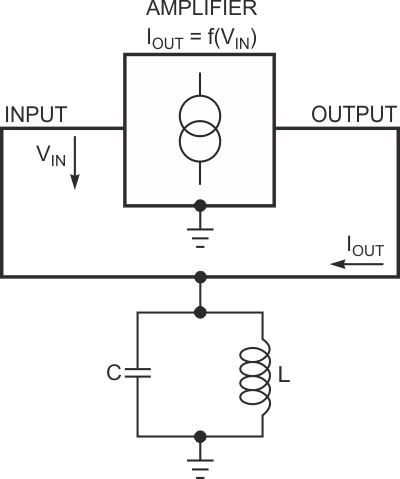

| Figure 1. | A parallel LC circuit and an amplifying voltage-to-current converter form a basic oscillator.  |
Designers have exploited many circuit topologies – some highly complex – in their attempts to achieve these design goals, but certain active devices' basic properties can help designers obtain acceptable behavior from a simple oscillator circuit. Figure 1 shows a basic LC-oscillator arrangement. The amplifier operates as a noninverting voltage-controlled current source. The LC circuit converts the amplifier's output current, IOUT, to voltage, VIN, and applies it as input to the amplifier. Equation 1 shows the formal condition for oscillation:
			(1) |
In this equation, AO is the overall voltage amplification and RD is the LC circuit's dynamic resistance at its resonant frequency. In practical circuits, the value of RD depends on the LC circuit's properties and thus can fall anywhere within a wide range. Also, Equation 1 assumes an ideal amplifier – that is, one having characteristics that are independent of frequency.
Figure 1 and Equation 1 yield a simple insight into the basic design problem: If the operation over a wide frequency range demands the use of several LC circuits with widely varying values of RD, the amplifier's properties must be adjustable over a wide range. You can adjust the amplification to fulfill the gain-limitation condition for the worst-case LC circuit and then rely on device nonlinearities to reduce amplification under overdrive conditions. However, a heavily overdriven amplifier's input- and output-differential resistances can drop to a fraction of their optimum, high-resistance values. Second, large amounts of nonlinear distortion can impair frequency stability. Moreover, these effects depend heavily on the amplifier's power-supply voltage, causing frequency stability to deteriorate if the supply voltage varies with load.

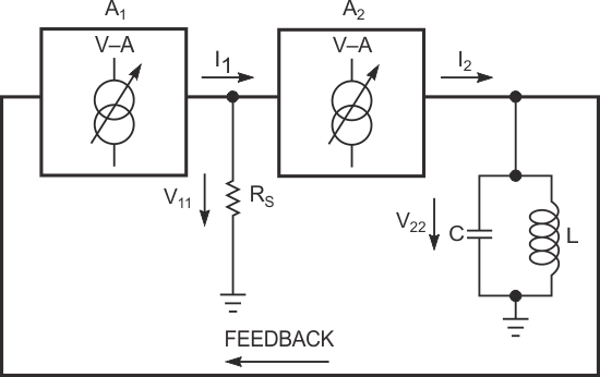

| Figure 2. | Adding a second voltage-to-current converter isolates the tuned circuit. |

As Figure 2 shows, another oscillator topology features two cascaded noninverting amplifiers, A1 and A2, as voltage-to-current converters (voltage-controlled current sources). In the circuit, coupling resistor RS converts amplifier A1’s output current, IIN, to voltage VIN, and drives the second stage, A2. The tuned circuit's dynamic resistance converts A2’s output current to output voltage, V22, which feeds back to A1’s input to complete the positive-feedback loop. The overall loop amplification, ATOTAL, appears in Equation 2:
			(2) |
In this equation, RD = QωL is the dynamic resistance of the LC circuit at resonance at the ω frequency, Q is the quality factor of the LC circuit, A1 and A2 are the equivalent voltage amplifications of both amplifier stages, and |y21S1| and |y21S2| are the real parts of differential-forward-transfer admittances of both amplifying stages. For self-sustained oscillations, the basic condition ATOTAL > 1 in Equation 1 must apply for all values of the LC circuit's dynamic resistance, RD. In theory, this condition presents no problem; however, in practice, a situation arises in which the circuit must operate as an LC oscillator with a broad range of tuning inductances and capacitances; a wide range of tuned-circuit quality-factor Q, which the inductor primarily determines; a constant-amplitude output at any combination of conditions A and B; and the best possible frequency stability versus supply voltage and load.

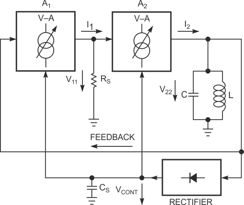

| Figure 3. | Rectifying a portion of the signal provides a gain-control voltage for the amplifiers. |
Most LC oscillator circuits cannot simultaneously fulfill all of these requirements. Some oscillator circuits can sequentially fulfill some requirements, but none can fulfill all of them without complicating the circuit beyond reasonable limits. Figure 3 shows a circuit deriving an external dc control signal from V22 to control the voltage-to-current-conversion coefficients – that is, amplification factors – of A1 and A2. Applying amplification control to both stages considerably increases the control's effectiveness. In addition to the original positive feedback for starting and sustaining oscillation, you can add an indirect negative-feedback path to the oscillator circuit to limit V22’s amplitude. To meet the original design goals, amplifier blocks A1 and A2 should exhibit voltage-controlled input-versus-output characteristics, should possess linear-control amplification characteristics (Figure 4), should not invert the signal's phase, and should draw nearly no input current. Also, to emulate a current source, A2 should present the highest possible differential internal output resistance.

The gate-source junction of Q1 rectifies the ac voltage, V22, across the tuned circuit. Coupling capacitor C4 in Figure 5 doubles as dc-voltage-smoothing capacitor CS in Figure 3 because its bottom electrode connects to ground through the low dc resistance of tuning coil L. The dc-control voltage drives the gate of Q2 through resistor R2. Capacitor C2 connects Q2’s gate to ground for ac signals, and Q2 operates in common-gate connection because Q1’s source drives Q2’s source. To minimize frequency variations due to changing loads, a relatively low-value resistor, R4, in series with Q1’s drain, isolates the output from the circuit's frequency-determining components. In addition, one lead each of L and C connects to ground.
