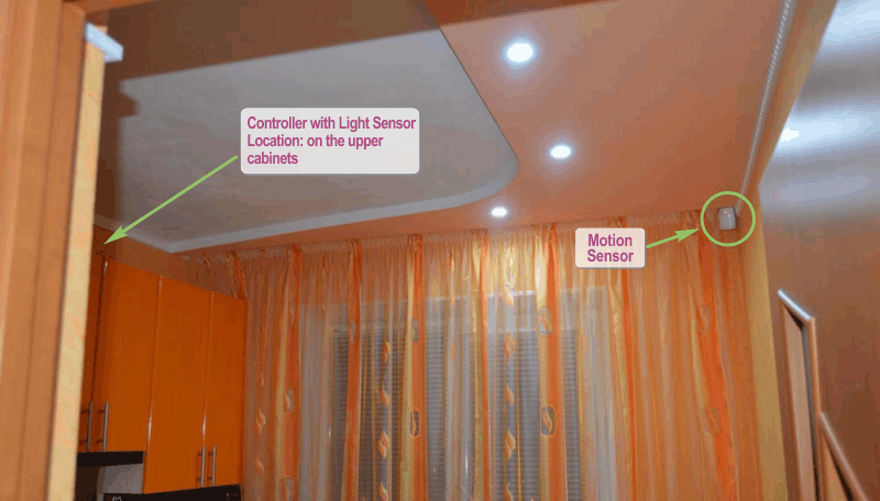

As a light sensor I using a miniature LDR VT93N1 (nominal resistance 12 kOhm), in simple wiring diagram (with resistor R3 forms a resistive divider) connected to an Arduino analog input A7.
For human movement detection in a room I used the IR motion sensor Foton-9 from the security alarm system (it is important point, do not confuse with motion sensors to control lighting devices). Any similar motion sensor with normally closed relay contacts and supply voltage of 12 V can be applied without the circuit and firmware changing. Motion sensor connected to the controller by a combined connector TB1-TB2 (screw terminal connectors). The motion sensor signal line (see sensor datasheet) is connected to Arduino port D2, which is configured as an input with internal pull-up resistor. In the normal state motion sensor relay contacts (NC and C) are closed, then to D2 supplied low level. Then motion detected relay opens and the internal pull-up resistor provides high level on D2 input.
Note that the IR motion sensors from different manufacturers have different sensitivity (in most cases, regulated) and detection pattern, so the choice of sensor mounting location is time-consuming process. In my case, the sensor is located in the upper right corner opposite the kitchen entrance (Figure 5) and, thanks to the good sensitivity, is triggered by a person approaching the entrance to the room, so the light turns on in advance.

Figure 5. Location of controller with LDR, IR motion sensor and main lighting.

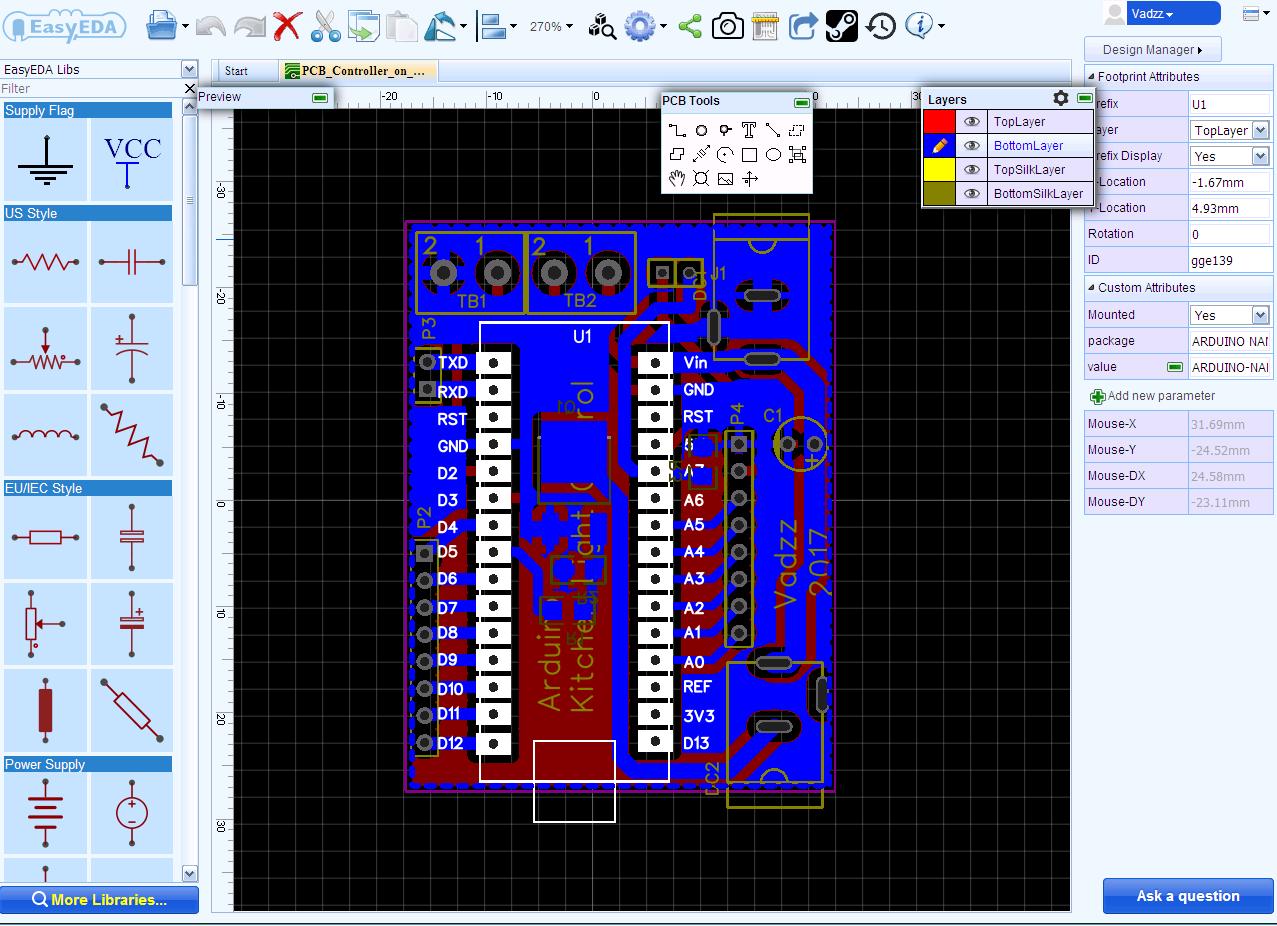

The Printed Circuit Board of the controller is also developed in online EasyEDA PCB editor from schematic. Placing packages of the elements specified in the schematic, and their grouping within the board edge can be carried out automatically at one click in the editor. Components packages are placed consecutively and compact, but do not overlap each other. As well as the schematic diagram creation in EasyEDA, the PCB design are very easy and quick (Figure 6).
PCB Designing in EasyEDA.
Figure 6. PCB Designing in EasyEDA.
After manual placement of components on the board you can perform an automatic trace or draw  traces in manual mode. The autorouter is very easy to set up, works quickly and efficiently. All the tools needed for manual drawing and editing elements, layers, switching display modes are available in the control panel.

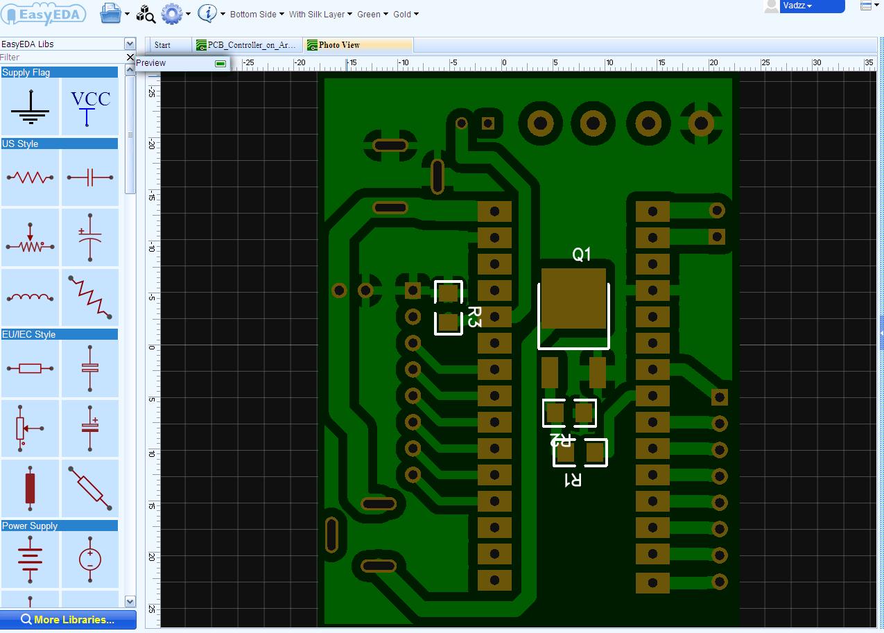

PCB for controller is double-sided, but  without vias. For top and bottom layer I use “Copper Area” with GND and silk-screen printing on the upper layer (Figure 7). PCB production order issued directly from the editor, it will automatically be generated Gerber-files of my project (file is available for download in the downloads section). In addition, EasyEDA built a very useful tool for viewing Gerber-files - GerberViewer. Minimum order (5 pcs.) was carried out within 3 business days and mailed.
Photo view of the printed circuit board in EasyEDA editor.
Figure 7. Photo view of the printed circuit board in EasyEDA editor.
Boards quality is very pleased (Figure 8). Perhaps this is not the case to judge the equipment and production capabilities, due to fairly wide printed conductors and large gaps, but looks good. The quality of the tracks, silk-screen, plating holes have no complaints. All sizes, including diameters of the holes correspond to the project, the findings of all the elements installed in the holes without effort.
