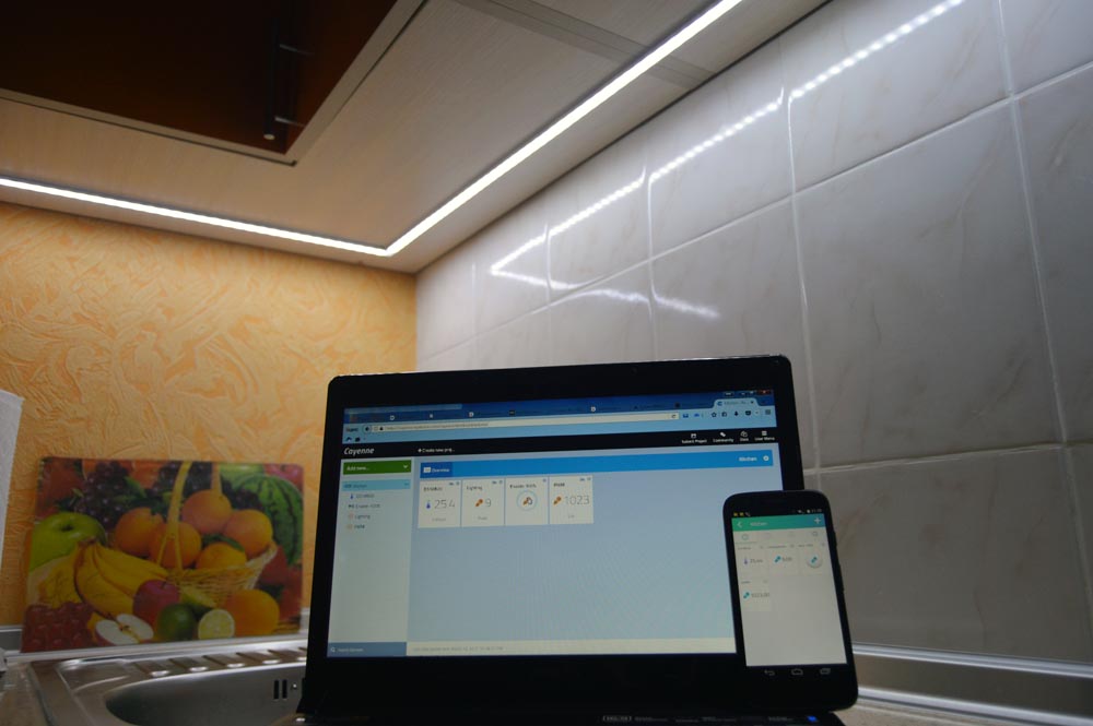

The second version of the controller is made on a popular  Wi-Fi module such as NodeMCU, which is based on the powerful Espressif ESP8266 system-on-chip (SoC). Such a solution will allow us to implement in our light controller additional functions inherent in the devices of the Internet of things (Figure 10). At this moment, there are many varieties of these Wi-Fi modules, which have different form factor, the number of general purpose I/O lines, the presence of an interface for debugging and programming. This diversity is due to the high popularity of Wi-Fi modules among radio amateurs and designers, as well as full support for the ESP8266 core in the Arduino integrated development environment. In other words, it is a miniature Arduino board with a Wi-Fi interface, with which you can create Internet devices of things (IoT) with enough rich functionality.
Сontroller for automatic lighting of the working area in the kitchen
Figure 10. Kitchen working area accent lighting with automatic control on
NodeMCU support IoT functions.
Next, we will look in detail at construction and the operation principle of this version of the controller.

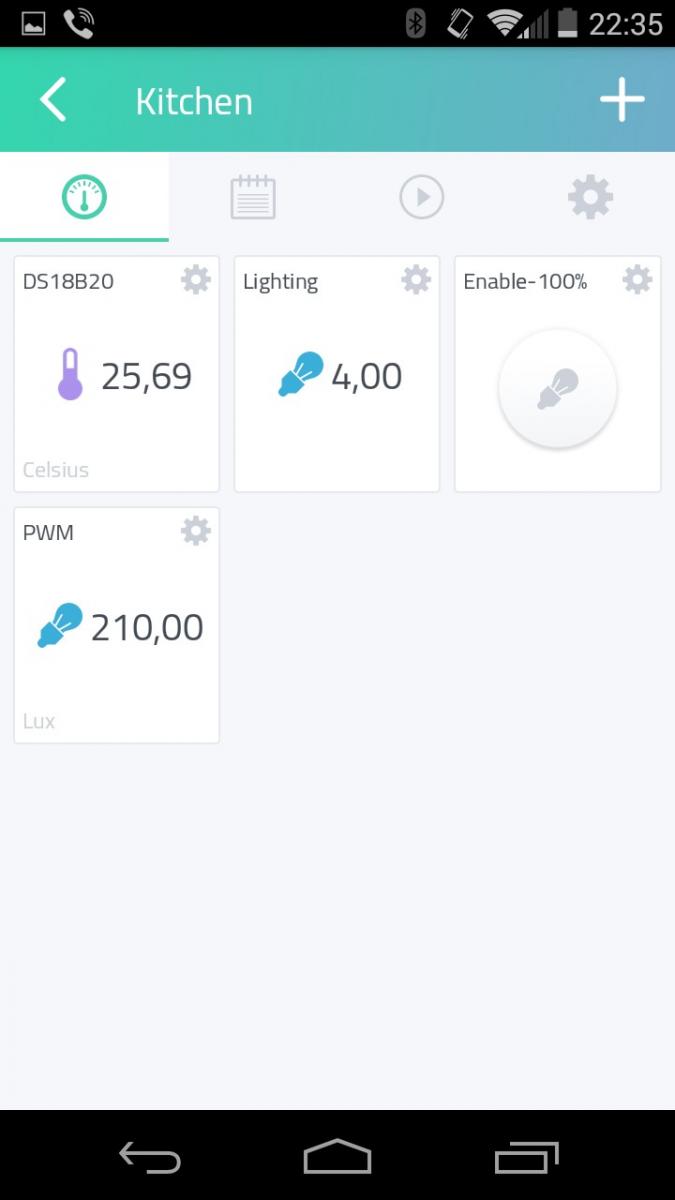

The idea to implement the IoT function in the additional light controller was born after I evaluated the possibilities of the cloud service and mobile application myDevices  Cayenne for developing IoT devices on Raspberry Pi and Arduino [1, 2]. I recommend that you familiarize yourself with the reviews published on our portal in order to understand the principle of building and operating the system.

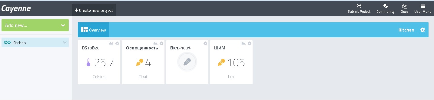

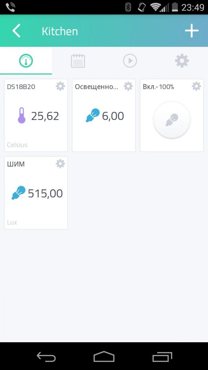

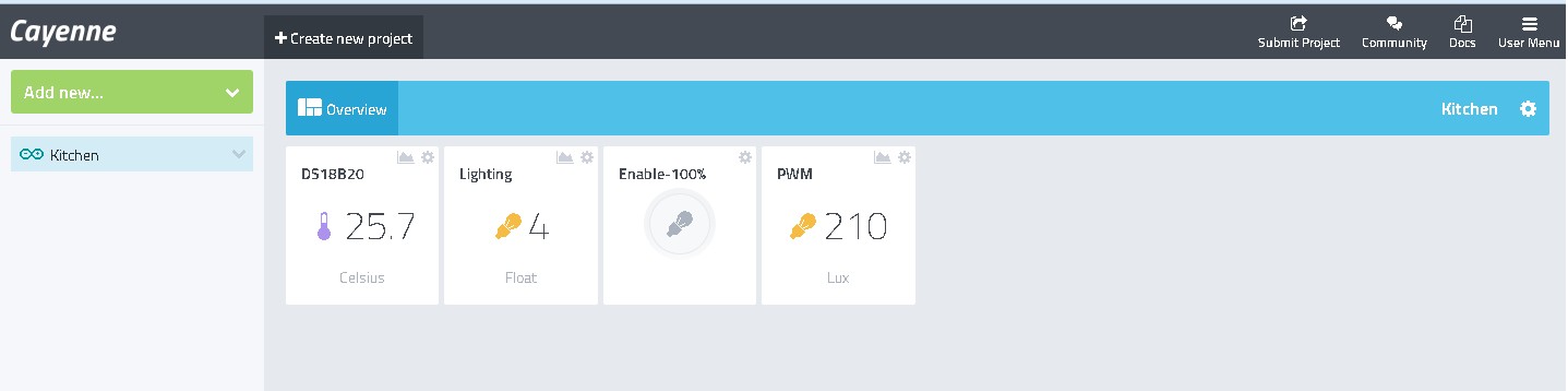

Now, considering that the device for automatic light control  supports the Internet connection (in particular, to the Cayenne server), we can implement additional useful remote control and management functions. At the moment on the Cayenne dashboard I can observe the level of illumination and its change, the current PWM mode of controller, the temperature in the room, and also I can switch the controller to manual mode from the application on the smartphone and turn the additional light  to maximum brightness (Figure 11). All data arriving at the Cayenne server is saved, and in the future I can view detail data (and download) and statistics of changing data for different time periods, and also set up notification conditions for a mobile phone or e-mail (Figure 12). Thus, this controller, in addition to controlling the lighting of the working area in the kitchen, can perform additional automation functions and it can be called a remote sensor (sensor node).
a)
b)
Figure 11. Cayenne dashboard for automatic lighting controller in kitchen:
a) in the browser; b) in the mobile application.
Figure 12. One of the options for details display (statistics) of temperature
changes in the kitchen.

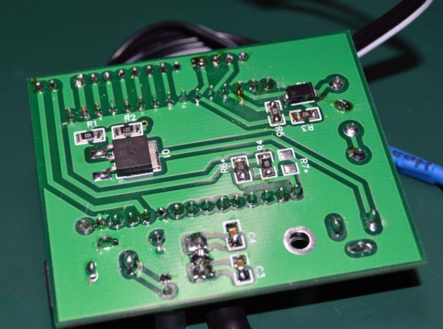

Printed Circuit Board (PCB)

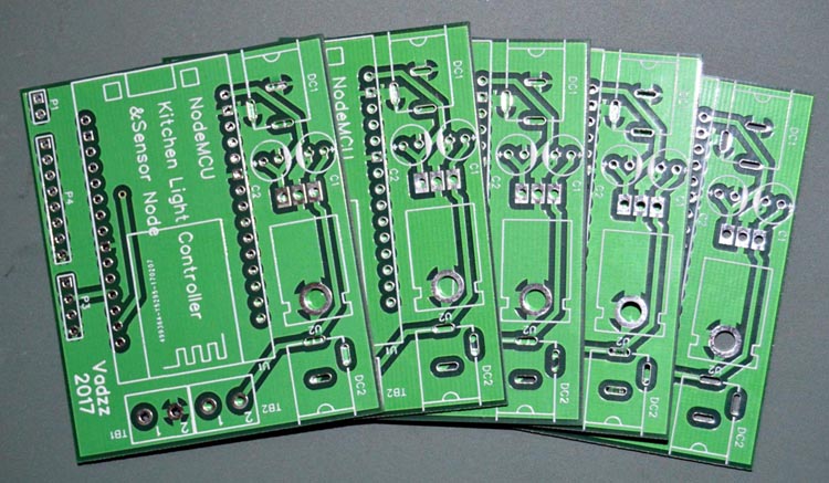

The design of the double-sided printed circuit board is developed in EasyEDA; Gerber files are available for download (Figure 14). The components and connectors tried to arrange the same way as on the Arduino Version, however, the board size was slightly larger. You can also view the project Gerber files using GerberViewer.
Контроллер управления подсветкой рабочей зоны на кухне
Figure 14. PCB for Controller on NodeMCU designed in EasyEDA.
The top and bottom layers are filled with Copper Area (GND, ground) and silkscreen. As with the Arduino board, the minimum order (5 pcs.) for PCB manufacturing was made as soon as possible, but in the end I received 6 PCBs.

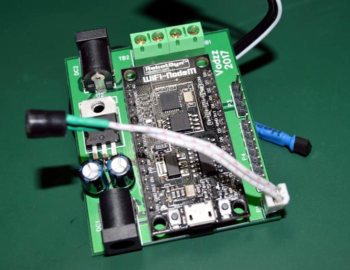

All components are installed freely, and I did not even check the sizes and diameters of the holes in the library components used. The resulting set of printed circuit boards is shown in Figure 15. The board with installed components is shown in Figure 16.
Figure 15. Printed circuit boards ordered and manufactured in EasyEDA.
Figure 16. View of the controller board on the NodeMCU
with the installed components.
