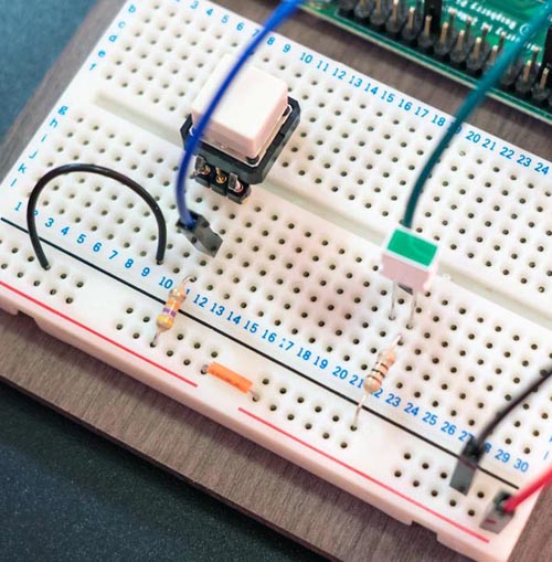

The connections on the Raspberry Pi can be converted into inputs under software control. The example here is about the simplest; a push button switch is wired up to the 40-pin connector (Figure 11).
Raspberry Pi GPIO Explained
Figure 11. Push button switch is wired up to the 40-pin connector.

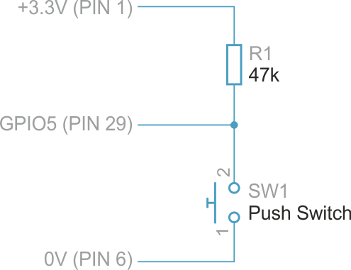

The circuit diagram is shown below (Figure 12). Note that the LED circuit from the exercises before is still left wired up but is not shown in the diagram below.
Figure 12. Schematic diagram for connecting
push button to RPi.
As can be seen from the circuit diagram, when the switch is not pressed the input pin is connected to +3.3 V through a resistor. The input pin has a high resistance inside the Raspberry Pi, and so the voltage at the input pin is close to the 3.3 V that the resistor is connected to. This means that the Raspberry Pi will detect a logic ‘1’ condition when the switch is not pressed.
When the switch is pressed, there is a direct path between the input pin and 0 V and so the voltage at the input pin becomes 0 V which is a logic ‘0’ condition.
For this simple switch circuit, the value of resistor R1 is not critical and can be any resistance from around 1k to 47k, but avoid low values since that increases current consumption when the switch is pressed.

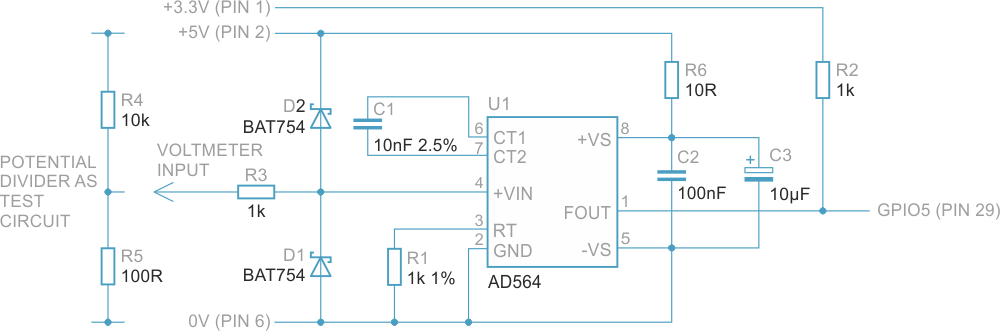

The example is an extremely simple voltmeter (Figure 13, 14); it can measure voltages between 0 and 1 V with good precision. Note that this won’t replace a handheld multimeter! It doesn’t have the requisite safety protection and could damage itself or persons or property if used for anything beyond the scope of the examples described here.
Figure 14. Voltmeter circuit on bread board.
The circuit uses an AD654 integrated circuit which generates a square wave with frequency dependant on an input voltage. The square wave output is connected to a Raspberry Pi input (GPIO5 in this example). The square wave has a frequency of up to 10 kHz and so some accurate timing is needed to determine the voltmeter input. The code (file Listing_6(Voltmeter).txt) uses the C programming language and a library called wiringpi written by Gordon Henderson. First off, install the wiringpi library:

The code uses an averaging method to get high precision. It rapidly measures the width of the incoming square wave 64 times, and then sums the values and divides by 64 to get the average value. Then it sleeps for a second to allow other processes to do their thing, and then repeats.
The circuit also needs a few things for high precision. The 10 nF timing capacitor for the AD564 is selected to be a polypropylene part for better accuracy. The 1 k timing resistor can be a 1% part or alternatively a variable trimming resistor can be used. The circuit runs from the 5 V supply from the Raspberry Pi 40-pin connector but this is only approximately 5 V and so the circuit would benefit from a dedicated and more accurate 5 V supply circuit.
As a quick check, the circuit shown above had the voltmeter input subjected to a potential divider circuit consisting of two resistors. The calculated voltage (if the resistors were precisely the correct values and the supply was exactly 5 V) out of the potential divider is 0.04950 V. When the software was run, it reported measurements of 0.04991V in the short test. Not bad for such a simple project!
Diodes D1 and D2 in the circuit above are optional but highly recommended because they will provide some protection to the integrated circuit if the input is accidentally subjected to a voltage outside the 0-1V range.

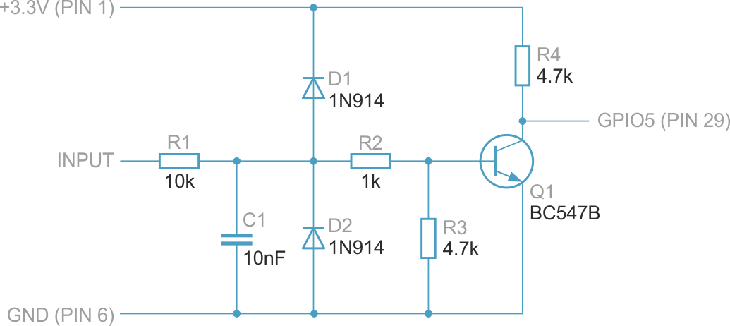

The Raspberry Pi can be protected from accidental connections to higher than expected voltages by adding an additional circuit to the inputs in use. A very good option in some situations is to use an optocoupler alternatively a low-cost method such as the circuit below will tolerate voltages as high as 60 V without damaging the Raspberry Pi, and will cope with reversed connections too (Figure 15). The BC547B transistor in the circuit can be replaced with another type such as 2N3904 or BC549 if more convenient to obtain. R1 can be a (normal) 0.25 W resistor for inputs up to around 50 V, and will need to be a 0.5 W part otherwise.
Figure 15. Additional circuit for protecting RPi digital inputs.
The output of this circuit is inverted, and an input voltage higher than about 2 V will pull the output low.

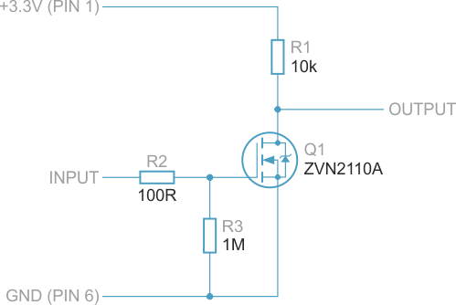

A direct connection of a 5 V logic output to a Raspberry Pi input could cause damage. Different approaches can be taken depending on the specific need.
If the 5 V logic output changes slowly then you could consider using a potential divider circuit (i.e. two resistors) but it is not a great method (it doesn’t work for fast circuits). A far better method is to use a 5 V tolerant buffer integrated circuit. A mid-way approach adequate for up to 100 kHz switching speed is shown below (Figure 16), using a ZVN2110A N-channel MOSFET. The output is inverted.
Figure 16. Simply Logic Level Converter circuit.
Alternative MOSFETs that are suitable include ZVNL120A and VN10LP.
MOSFETs are easy to damage when unsoldered in a circuit due to a very delicate gate structure (it is made of a thin layer internally that can be destroyed with high voltage). Take electrostatic precautions and another good practice is to first connect R3 into your circuit (either on a circuit board or breadboard) and then remove the MOSFET from its safe packaging and connect it into the circuit. The resistor R3 will provide some protection.

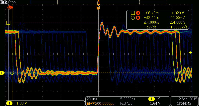

To find out, code was written to repeatedly toggle an output pin and an oscilloscope was connected up. The results are shown below (Table 1).
Table 1. Output signals toggle speed when using Puthon,
C and Shell Script
Language Frequency High period Low period
Python 71.2 kHz 3.9 µsec 10.1 µsec
С 5.8 MHz 85 nsec 85 nsec
Shell Script 3.9 kHz 115 µsec 139 µsec
However, it is always important to remember there is jitter that will be present due to the use of the Linux OS. This is not an issue for general LED toggling of course. The oscilloscope capture below shows part of the nature of the jitter by overlaying multiple traces triggered at the same time (Figure 17). Notice that the jitter can take on many values, although they are all discretely spaced 4 nsec apart (250 MHz) which is due to internal hardware inside the Raspberry Pi.
