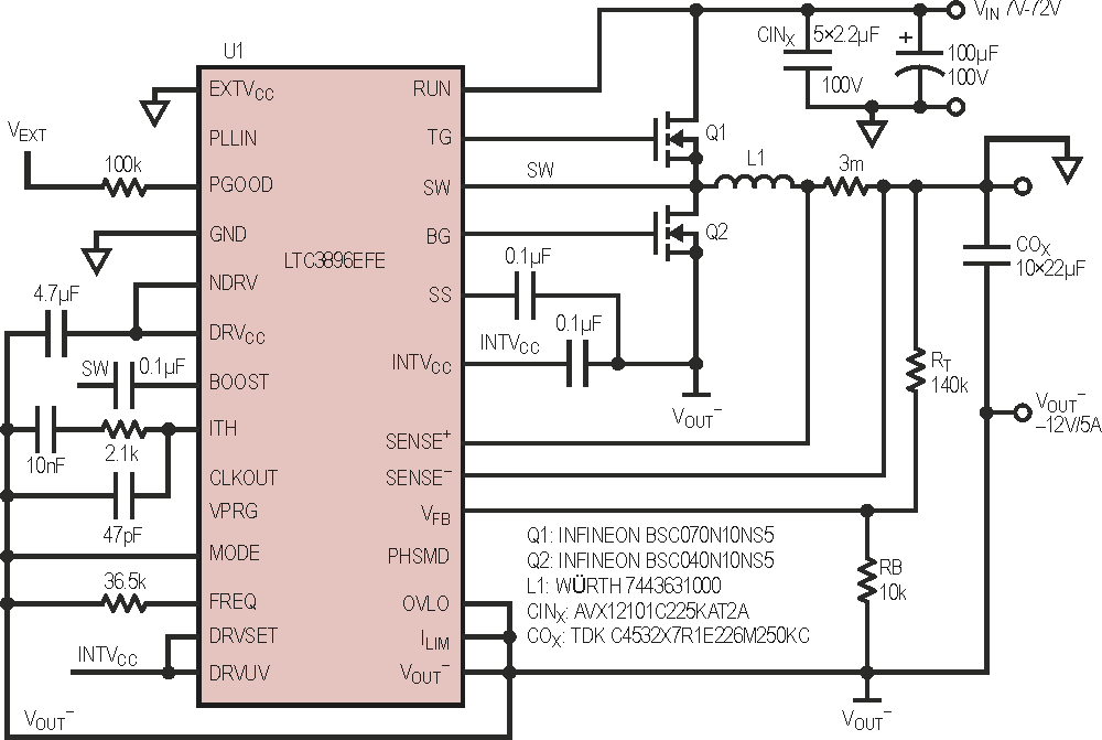

Wide 7 V to 72 V Input to −12 V at 5 A Output
Figure 1 shows a positive to negative converter based on the LTC3896. This solution delivers −12 V at 5 A from a 7 V to 72 V input voltage range. In the automotive market, the LTC3896’s ability to handle high input voltages eliminates the need for bulky and costly voltage suppressors, while the low minimum input voltage keeps sensitive systems operational even during cold crank conditions.
High Voltage, High Efficiency Positive to Negative Converter
Figure 1. The –12 V Output Converter (U1) Provides 5 A to the Load in the Input
Voltage Range from 7 V to 72 V. Note Control Signals RUN, PGOOD
and PLLIN are Referenced to GND.
The power train of the converter comprises MOSFETs Q1, Q2 and inductor L1. The output filter is based on ceramic capacitors COX. The EXTVCC pin of U1 is connected to GND, producing a 12 V potential at this pin relative to VOUT–. If a power good signal is required, an external voltage source referenced to GND should be employed. The LTC3896’s control and interface signals, including RUN, PGOOD and PLLIN are referenced to the system GND to eliminate the need for level shifters in processor controlled systems.
The guidelines for calculating voltage and current stress on the components surrounding the LTC3896 are detailed in the data sheet. For a basic evaluation, duty cycle (D), average inductor current (IL) and MOSFET voltage stress (VDS) can be calculated by the following:

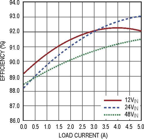

Figure 2. Efficiency Curves for the Circuit in Figure 1. Output
Voltage is –12 V and Maximum Load Current is 5 A.
Figure 2 shows efficiency at various input voltages. Figure 3 shows a thermal image of the converter in action.
