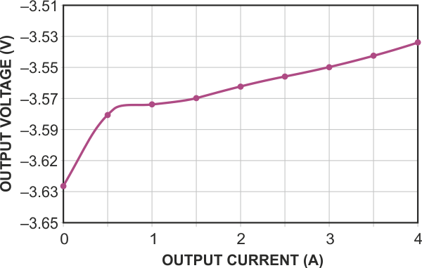

Figure 2. Output voltage for the circuit in Figure 1
varies with output current.

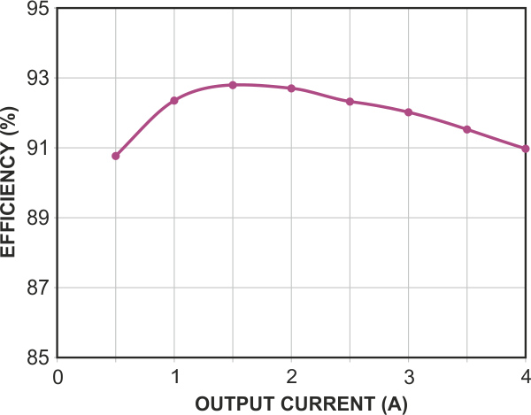

The component values in Figure 1 – for example, 1.96 kΩ for R5 and R7 and 5.76 kΩ for R4 and R6 – produce an output voltage of –3.76 V. Graphs of output voltage versus output current (Figure 2) and efficiency versus output current (Figure 3) illustrate this circuit’s performance.
Negative-to-negative switch-mode converter offers high current and high efficiency
Figure 3. Conversion efficiency for the circuit in Figure 1
