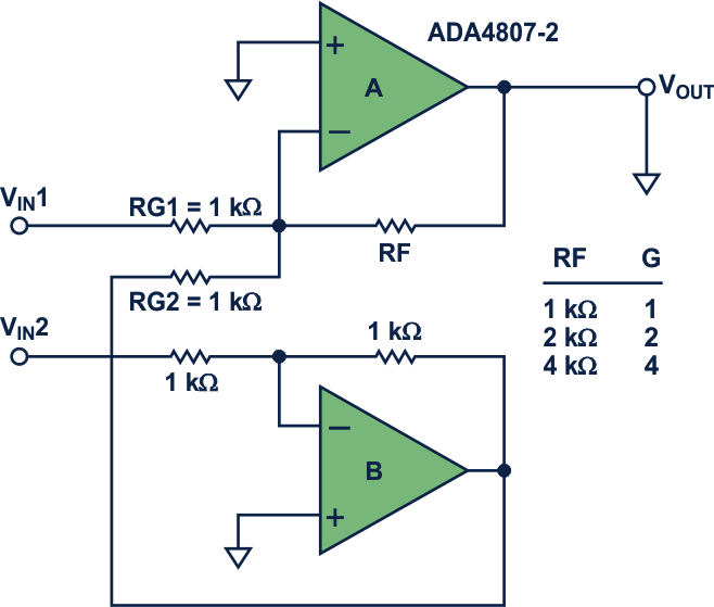

Figure 1. The differential input, single-ended output amplifier.
A simple solution is to use dual precision amplifiers with a resistive gain network, as shown in Figure 1. This circuit shows a simple way of converting a differential input to a single-ended output with adjustable gain. The gain of the system can be set by Equation 1:

where G = RF/1 kΩ and (VIN1 – VIN2) is the differential input voltage.

The circuit can convert a differential input to a single-ended output with an adjustable gain. The gain of the system can be set by the ratio of RF and RG1 with the assumption that RG2 = RG1 and amplifier B has a gain of –1.
For example, the ADA4807-2, a 180 MHz dual amplifier, can be built as an inverting amplifier for this application and this circuit provides lower noise. With a low quiescent current of 1000 μA per amplifier, the circuit is ideal for low power, high resolution data conversion systems.

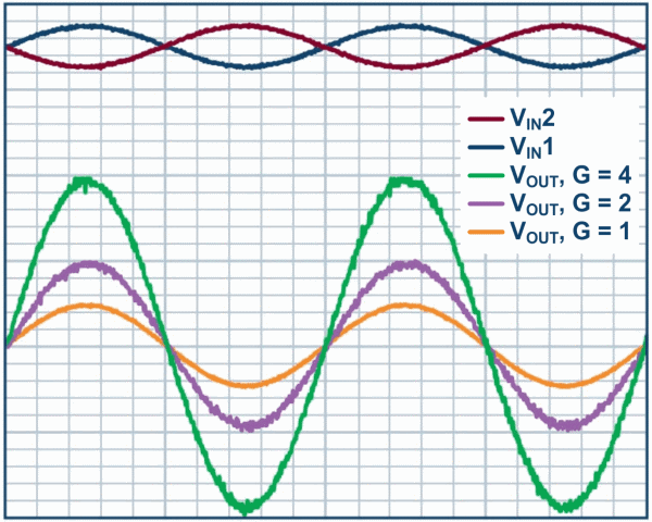

The plot in Figure 2 was taken by applying a differential input voltage and varying the gain of the circuit. The value of RF sets the gain of the system. As one can observe, the plot shows the system gain of 1, 2, and 4, with the differential input voltage of 1 V p-p at 1 kHz.

Figure 2. The performance of the simple differential to
single-ended amplifier.
