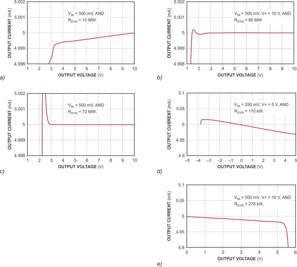

Op-amps connected as high impedance current sinks or sources
Figure 2. These graphs show output current versus output-voltage characteristics for the circuits in Figure 1.
Note that for b and c, the dynamic-output-impedance characteristic closely resembles that of an
ideal current source: ΔVOUT/ΔVIN=∞.
For a fixed value of output current in each of the five circuits in Figure 1, the graphs of Figure 2 show the circuits' dynamic impedance and range of useful output voltage (current compliance). The graphs show a high nominal output current of 5 mA to better display the higher end of the current-amplitude range. Depending on your application, you can optimize each circuit's dynamic impedance and current range through a judicious choice of op amps and resistor values.
