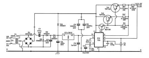

Power Supply 2-7 V / 6-8 A by 723 and 7812
Description: In this 2-7 V power supply circuit, for our purpose, we chose IC 723 instead of a three pin voltage regulator for-why we find it protean and more advantageous in technical details.
Notes: Heatsinks of Tr2 and Tr3 transistors must be sufficiently large. To archive R4,R5 and R6 values, we used some suitable resistors in parallel. For R4 and R5 two parallel connected 0.3 ohm / 5 W resistors for each are used. To take 6 A output, we connected two 0.22 ohm / 5 W resistors in parallel, and to take 8 A output we connected three 0.33 ohm / 5 W resistors in parallel instead of R6 resistor.
2-7 V / 6-8 A Power Supply by 723 and 7812
If you change the marked component values properly you can get up to 14 V output. For this situation you must disconnect R1,R2,C5,C6,C1,C2,D1,D2 components and connect the positive terminal of D3 directly to the rectified and stabilized supply. TIP142 is a darlington transistor so you can not change it with other normal transistors.
For an example of the circuit operation; When a 0.68 ohm load was connected, we desired to take 8 A current at 5.5 V but voltage drop was about 0.18 V. This means at 5.32 V we got 7.8 A and error was about % 3.3. At the same condition, ripple voltage was less than 25 V (rms).
