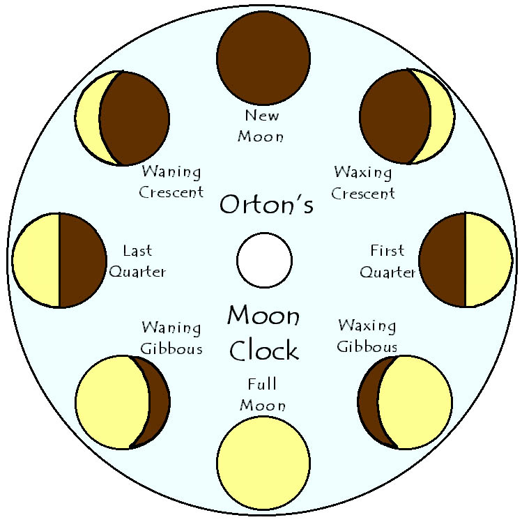

Firstly, all of the hands are removed, and the clock face is substituted with the Moon Dial face shown in the graphic below. Only the hour hand is refitted to the central cluster (but retain the second for the moment - it may prove useful later).

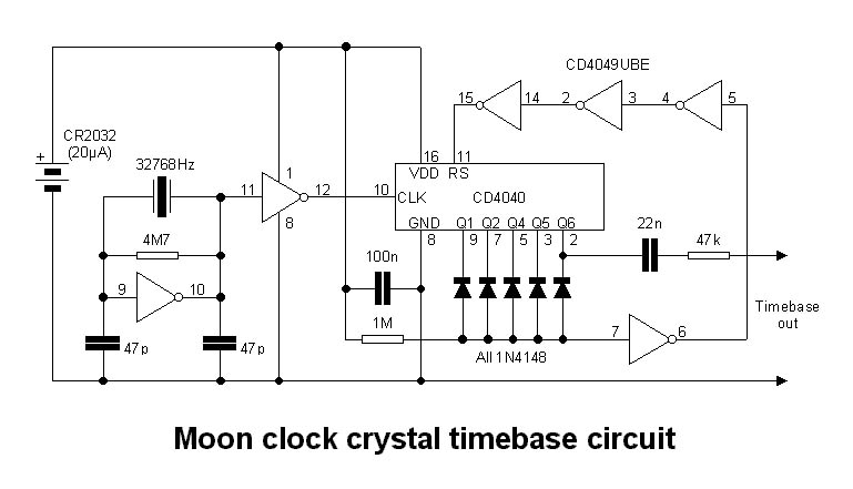

Next, the crystal is removed. Instead of the crystal, we are going to drive the clock from a timebase of our own making, the purpose being to slow the clock down by a factor of 59. Doing this results in the hour hand completing a revolution in 29.5 days - almost precisely the time taken for the moon to do one circuit around it's phases! I have found this to be possible, at least on the clocks I have attacked (and they are nothing out of the ordinary as these clocks go). The funny little motors in these clocks don't seem to mind at all being driven many times slower than is normal.
Now, if you want a precision astronomical instrument, I recommend you build a crystal timebase, using the crystal removed from the clock. A suitable CMOS circuit is shown below.

Having removed the crystal, we inject our own timebase into one of the now open crystal connections. But which? I probed the open terminals with a DVM. I found one to be close to the negative supply, and the other close to mid-supply. I assumed the one at mid-supply would be the input terminal to the oscillator. This proved to be wrong! My suggestion - trial and error. If the second hand is re-attached, then you don't have to wait very long to see evidence of the clock counting our timebase frequency - the second hand will advance.
The second hand should advance every 59 seconds, and the 'Freq' preset in the simple timebase should be adjusted until this is the case (if you are lucky enough to own a frequency meter, then adjust for a frequency of 554.83 Hz). Once set, the second hand can be removed again, and the clock closed up before any of those tiny components fall out!
