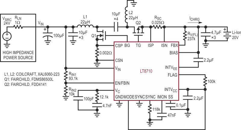

Circuit description and functionality
Figure 1 shows a charger solution for a 20 V lithium-ion battery, commonly used in portable power tools. The voltage source, VSRC, is 24 V via a high impedance power line, resistor RLN, resulting in the voltage VIN at the charger input terminals. The voltage source could be considered as a popular 12 V solar panel with 22 V to 24 V open-circuit and 18 V to 19 V optimum operating voltage. The charger is based on a synchronous non-coupled SEPIC topology and controlled by the LT8710. The power train consists of discrete inductors L1, L2, transistors Q1, Q2, decoupling capacitors between the inductors, and input/output filters. Resistor RSC sets 2 A of charge current, ICHRG; resistor RV(FL) sets the float voltage of 21 V. The resistor divider RIN1, RIN2 sets input voltage regulation level which is 18.6 V in this example.
| Figure 1. | Electrical Schematic of LT8710 Li-Ion Battery Charger In High Impedance Input Lines. | |

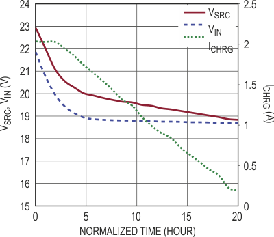

Figure 2 illustrates the functionality of the charging solution over time. When VIN and power source voltage VSRC are above 19 V, the LT8710-based SEPIC charges the lithium ion battery to the programmed 2 A, ICHRG. As VSRC drops below 20 V, the value of VIN drops correspondingly. When VIN reaches the input voltage regulation level, the LT8710 reduces the charging current, ICHRG, to maintain VIN, even as VSRC continues to decline. The horizontal axis represents normalized time, which can be hours for a solar panel, or minutes, or seconds for power supplies in complex industrial systems.
| Figure 2. | Graphs of Charging Current (ICHRG) as a Function of the Voltages Power Supply (VSRC) and Charger Input Terminals (VIN). |
