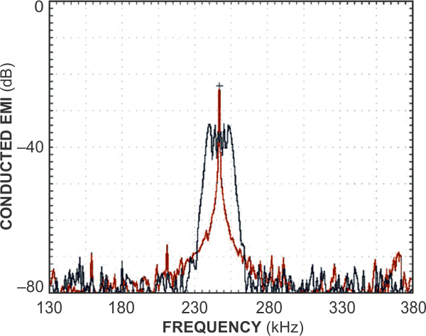

An LM5020-controlled PWM flyback dc/dc converter, IC1, evaluates the dither circuit's effectiveness. The circuit's fundamental operating frequency is 250 kHz, which the controller's RT resistor sets. The red trace of Figure 2 shows the conducted emissions on the circuit's positive input-power line without the dither circuit in operation. The peak emissions are narrowly confined around the fundamental oscillator frequency of 250 kHz with a measured amplitude at the fundamental frequency of –24 dB.
Measured at the dc/dc converter's input, peak conducted emissions without dither (red trace) decrease by 10 dB with dithering applied (blue trace).
Figure 2. Measured at the dc/dc converter’s input, peak conducted
Connecting the dither circuit to the controller's RT input produces the blue trace of Figure 2. Conducted emissions around the fundamental frequency now disperse around the fundamental frequency with maximum amplitude reduced by –34 to +10 dB.
