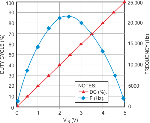

A previous design idea is reminiscent of a similar but somewhat simpler circuit (see [1]). This circuit delivers a rectangular signal with duty cycle varying between 0 and 100% in response to an input signal varying from 0 to 5 V dc (Figure 1). As with the above-mentioned circuit, the frequency is not constant (Figure 2), but the circuit is so simple that it can be useful in certain applications. In response to the hysteresis R2 provides and the time constant R3C1, the comparator delivers the rectangular wave (Figure 3). The voltage V– at the inverting input swings between the two threshold levels, VTH and VTL. If you assume that R2 >> R1, then V+ is always very close to VIN. R3C1 averages the signal at VOUT, and the dc voltage at V– is proportional to the duty cycle of VOUT. The closed feedback loop tries to make V– equal to V+; therefore, the duty cycle at VOUT is proportional to VIN.

Output frequency is a nonlinear function of the input voltage.
Figure 2. Output frequency is a nonlinear function of the input voltage.

You can see that the duty cycle is directly proportional to VIN: 0% for VIN = 0 V and 100% for VIN = VOH. Moreover, the duty cycle is essentially independent of the component values, with the constraint that R2 >> R1 to keep hysteresis small. An inverse relationship between duty cycle and VOH can be useful in some applications, so consider VOH as an additional input. The output frequency follows the relationship
reaching its maximum at VIN = VOH/2.
