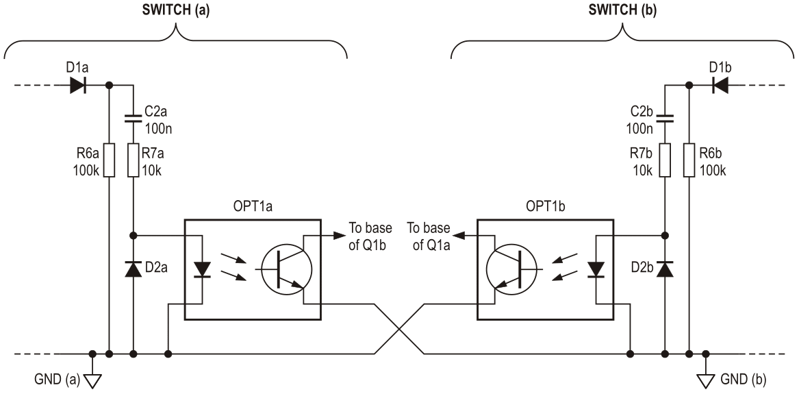

Although switch (a) and switch (b) are identical, they do not need to share the same supply voltage, i.e., +VS(a) and +VS(b) do not need to be equal and can be derived from different sources. However, for the circuit in Figure 1 to achieve cross-coupling, switch (a) and switch (b) must share a common ground return (0 V). For applications where this is a problem, Q3a and Q3b can be replaced by optocouplers (Figure 2), which allows each switch to have its own ground return, galvanically isolated from the other. Most common-or-garden optocouplers should work perfectly well, but remember that the opto’s LED requires more drive voltage than a transistor, so it may be necessary to reduce the value of R7 (and increase C2 accordingly) if the supply voltage, +VS, is fairly low.
Optocouplers allow for completely isolated cross-coupled switches.
Figure 2. Optocouplers allow for completely isolated cross-coupled switches.

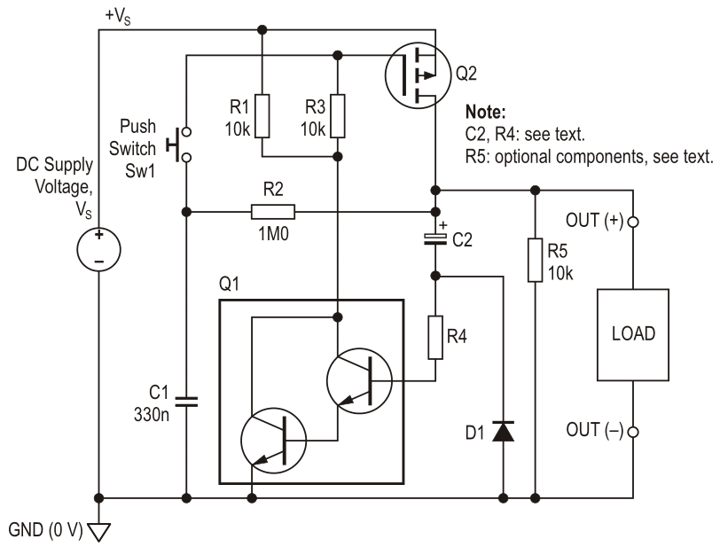

Certain applications may require a latching switch that turns off automatically after a preset period of time. A fairly simple way of achieving a timed output is shown in Figure 3, where Q1 has been changed from a single transistor to a Darlington pair, and capacitor C2 has been inserted between Q2’s drain and R4. As before, a momentary pushbutton, Sw1, is used to control the circuit. When the switch is closed, Q2 turns on and sources bias current to the Darlington’s base via C2 and R4. The circuit now latches into its energized state with Q2 held on via Q1.
Minor changes to the basic switch circuit allow for a preset timed output.
Figure 3. Minor changes to the basic switch circuit allow for a preset timed output.
C2 now begins to charge and the voltage at the junction of C2 and R4 falls at a rate largely determined by the C2-R4 time constant. As this voltage falls, so does the base current delivered to the Darlington via R4; eventually, the Darlington’s collector current becomes too small to provide sufficient gate drive for Q2 and the MOSFET switches off. The switch now reverts to its unlatched state and C2 discharges via D1 and the load in parallel with R5 (if fitted). Note that the switch can be unlatched at any point during the timed ’on’ period simply by pressing the pushbutton – it is not necessary to wait until the output has timed out.
The high current gain afforded by the Darlington pair allows for large values of R4 (on the order of several megaohms) to be used to produce a long time constant. A test circuit powered from a 15 V supply generated an ’on’ time ranging from around nine seconds with C2 = 1 µF and R4 = 1 MΩ to just over 15 minutes with C2 = 10 µF and R4 = 10 MΩ. Increasing C2 to 100 µF resulted in an ’on’ time well in excess of two hours.
