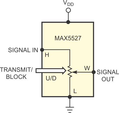

If you need only a few nonvolatile gates, consider using a component common in analog- and mixed-signal systems: the digital potentiometer (Figure 1). Ground the L end of the resistor string and route the signal into the H end of the string. Then, the wiper output either shorts to ground for blocking or connects to the input signal for transmission.
A programmable, nonvolatile digital potentiometer functions as a simple AND gate. Setting the wiper to the device's highest value allows the input signal to propagate to the output; setting the wiper to the lowest value blocks the input signal.
Figure 1. A programmable, nonvolatile digital potentiometer functions
as a simple AND gate. Setting the wiper to the device’s highest
