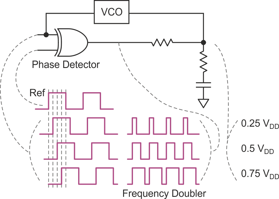

Pulse-width-modulation (PWM) derives an analog DC voltage level that results from the timing ratio between the successive high and low logic levels applied to the RC filter network. Starting from 0 V on the capacitor, each successive high pumps the capacitor a little higher in voltage until an equilibrium is reached after about five RC time constants. There will always be a small ripple on the averaged DC level (exaggerated in the figure). For best results, make the pulse frequency as high as possible, and make the RC time constant as long as possible – consistent with the required settling time.
We can take advantage of this effect in the most basic of digital-type phase detectors (Figure 2). The exclusive-OR function can be used in phase-locked-loops because the RC-filtered output voltage is directly proportional to the duty cycle resulting from the phase difference between its two input signals.
An XOR gate, voltage-controlled oscillator, and a few passive components make a frequency doubler.
Figure 2. An XOR gate, voltage-controlled oscillator, and a few passive
Feeding this RC filtered DC level back to the VCO servos its frequency into lock with the reference frequency. The resulting phase difference between the VCO output and the reference depends on the voltage that the VCO requires to run at the same frequency as the reference.
A side-effect is the frequency doubling aspect of the XOR phase detector. In fact, a similar effect can be harnessed as a frequency multiplier (Figure 3).

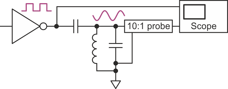

Driving a resonant LC tank circuit
Now we'll have a look at the neat things that you can do by driving a resonant LC tank circuit from a logic gate. Figure 3 touched on this. Now, let's have a peek at a bit more detail. Figure 7 shows the circuit.
A series of logic edges at a sub-harmonic of the tank resonant frequency will cause it to ring.
Figure 7. A series of logic edges at a sub-harmonic of the tank resonant frequency
Figure 8 shows the response of a tank tuned to 156.2 kHz to a single rising edge.
A single blue edge twangs the yellow tank like a guitar string. (Note all of the following figures have the colors swapped.)
Figure 8. A single blue edge twangs the yellow tank like a guitar string. (Note all
The tank circuit in Figure 7 uses an adjustable (ferrite slug tuned) 396 nH inductor in parallel with a 1 nF C0G (aka NP0) capacitor, and is loosely coupled to the TTL source through a 68 pF capacitor. It is not built on copperclad board or a PCB; the components are lying on the benchtop with their leads soldered together in the air. The inductor Q is spec'd on the data sheet about 88 at 40 MHz, so its Q (RF resistance/reactance) will be somewhat higher at the resonant frequency here of 8 MHz. The capacitor ratio depends on inductor Q (generally the capacitor Q is much better than the inductor Q), driver rise time, desired sine wave level, and following amplifier gain to restore the sine wave zero crossing to a digital edge.
In this case, for demonstration purposes the amplifier is represented by the oscilloscope, and the logic source is the TTL output of a function generator terminated into a 75 Ω cable and 75 Ω resistive load. Due to limitations of the function generator, the duty cycle is actually 48 percent, not the ideal 50 percent.
The 8 MHz resonant frequency is derived from the formula
But, the scope display in Figure 9 shows a frequency of the triggering yellow edges of 1.6 MHz – one fifth of the tank sine wave's frequency. This circuit is performing as a x5 frequency multiplier, and, in practice, odd harmonics up to the 11th or more are achievable depending on inductor Q. (I say 11th because that is the highest I've ever attempted.)
