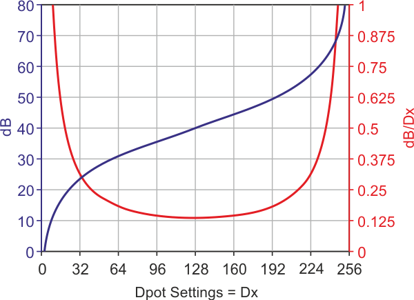

dB gain (y-axis at left) and gain set resolution (y-axis at right) vs. Dx (x-axis).
Figure 2. dB gain (y-axis at left) and gain set resolution (y-axis at right) vs. Dx (x-axis).
  1. The promised (approximate) logarithmic behavior of Dx/(255 – Dx). As shown in Figure 2, with R2/R1=100, Dx = 8 gives gain »10 dB; Dx = 23 yields 20 dB; 128 gives 40 dB; 232 gives 60 dB; and 247 gives 70 dB. That gain-setting resolution remains no worse than 1 dB over the entire 60 dB =1,000-to-1 range is especially significant. Additionally, Dx = 0 sets a gain of zero while Dx = 255 selects open-loop.
