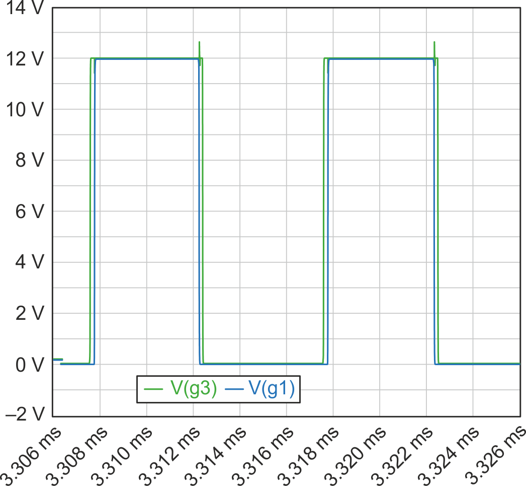

It is important to create proper gate-drive signals for M1 and M3 (Fig. 2). Transistor M3 should turn off earlier and turn on later than M1 to prevent a shoot-through current from the voltage source V3 through closed M3 and M1.
The gate-drive waveforms for M1 (blue) and M3 (green) show the relative timing needed to ensure proper, reliable operation of the circuit (horizontal: time; vertical: gate-drive voltage).

Two delay lines, whose parameters depend on the MOSFETs used, create the control voltage for M1 and M3. These delay lines are built on similar low-pass filters comprising resistors R5 and R6, capacitors C1 and C2, and diode D2 as well as symmetric counterparts R8, R9, C5, C6, and D1. A MOSFET driver with Schmitt triggers at the inputs is best.
Integrated circuit U2 is an example of an available PFC chip. The supply line is replaced with power source V1, and diodes D4 through D7 form a line rectifier. Almost any adequate power diodes can be used here.
IC U2 creates a pulse-width modulated control signal across resistor R17, which splits into two delay lines. When passed through the delay lines, it undergoes different delays of the leading and trailing edges due to the delay lines in both channels. This is how the gate-drive voltages of MOSFETs M1 and M3 are generated (Fig. 2, again).
