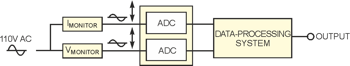

By adding two ADCs and a microcontroller, you can measure power-line voltage and current parameters.
Figure 2. By adding two ADCs and a microcontroller, you can measure power-line voltage and
current parameters.
If you connect the output to a 10-bit A/D converter, one LSB is equivalent to 0.5 V in the 110 V power line. You can add a Hall-effect sensor to the circuit for current measurements. The LTS series from LEM is suitable for this purpose, because these devices operate from a single 5 V supply and provide a 2.5 V-centered output. Figure 2 shows a system that integrates voltage and current measurements. The processor computes true-rms voltages and currents, apparent and active power, and power factor.
