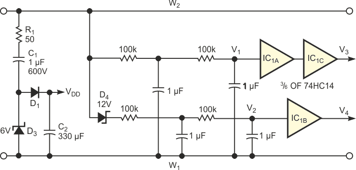

Figure 2 shows the first part of the control circuit located at the lamps' site, including the two leads of the power line, W1 and W2. Current through capacitor C1 and resistor R1 creates a 60-Hz square wave across the 6 V zener diode, D3. Diode D1 and filter capacitor C2 generate a dc supply voltage of VDD = 5 V for the control circuit's active elements. Two two-stage RC filters connected to W2 create V1 and V2, with reference to W1. The filters attenuate the 120 V-ac voltage between W1 and W2 to a subvolt level in V1 and V2. An extra zener diode, D4, creates a positive 5 V dc bias in V2. The filter outputs V1 and V2 drive inverting Schmitt triggers IC1 and IC2. Inserting zener diode D1 by pushing S1 in Figure 1 changes V1 from 0 V to 5 V and V2 from 5 V to 10 V. Inserting D2 in Figure 1 by pushing S2 changes V1 from 0 V to –5 V and V2 from 5 V to 0 V. Note that the input-protection diodes of IC1A and IC1B limit the voltage swings of V1 and V2. The output V3 of IC1C responds to pushing S1 by a positive transition and has no response to pushing S2. The output V4 of IC1B responds to pushing S2 by a positive transition and has no response to pushing S1.
This control circuit uses dc pulses from the circuit in Figure 1 to drive triacs in the circuit in Figure 3.
Figure 2. This control circuit uses dc pulses from the circuit in Figure 1 to drive triacs in the circuit in Figure 3.
