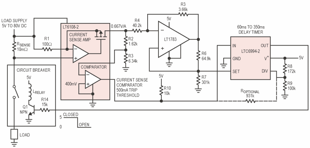

The circuit of Figure 1 has three distinct parts – circuit breaking, current sensing and timing.

The circuit breaking function can be any type of electronically controlled relay or solid state switch, properly sized for voltage and current ratings of the load being protected.
Load current sensing is achieved via an LT®6108-2 current sense amplifier with built-in comparator. The LT6108-2 converts the voltage drop across a small valued sense resistor to a ground-referenced output voltage that is directly proportional to the load current. The trip threshold is created by scaling the output voltage via resistor divider and feeding the result to the integrated comparator with a precision 400 mV voltage reference. The comparator changes state when the load current exceeds the threshold.
To prevent short duration transients from causing nuisance trips, an LTC®6994-2 Timerblox® delay timer is added between the comparator output and the circuit breaker. Once tripped, the comparator falling edge starts a variable time delay interval, which, if allowed to complete, signals the circuit breaker to open. Nothing happens if the transient duration is shorter than the delay.
A Current-Controlled Delay Interval
The LTC6994-2 delays from an edge appearing at its IN pin by a time ranging from 1 μs to 33 sec. The delay time is controlled by the current sourced by the SET pin, which programs an internal oscillator frequency, while the bias voltage on the DIV pin selects a frequency divide ratio.
The LT1783 op amp circuit takes the output voltage from the current sense amplifier and adjusts the SET pin current, thereby making the delay time a function of the load current (see Figure 2). As shown, the current sense comparator trip threshold is 500 mA. A current of 500 mA creates a falling edge and starts a time delay of 350 ms. Should the load current drop below 500 mA before the delay time expires, the timer output remains high and the circuit breaker does not trip.

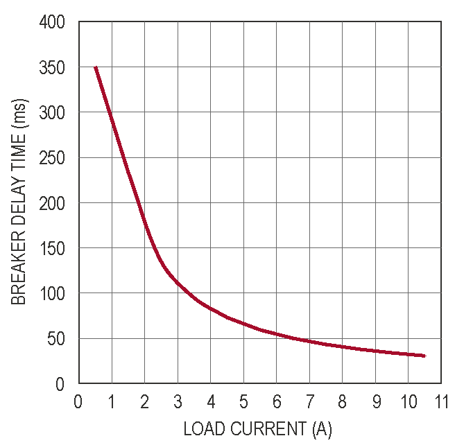

Low Current Transients Must Last Relatively Longer to Trip the Breaker. Higher Currents Trip the Circuit Breaker in Less Time.
Figure 2. Low Current Transients Must Last Relatively Longer to Trip the Breaker.
Higher load currents correspond to higher current sense amplifier output voltages, which in turn reduce the delay time interval (Figure 2). For instance, a 5 A load current trips the circuit breaker in only 60 ms. Depending on the average load current in excess of the 500 mA threshold, the delay interval or trip time will fall somewhere between 30 ms and 400 ms.

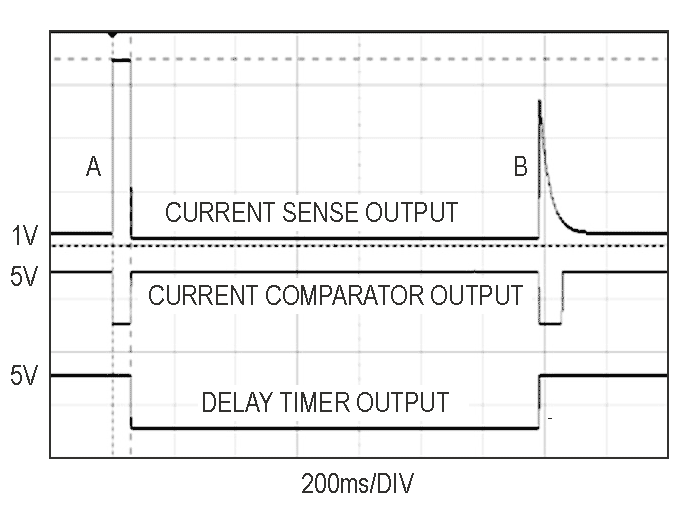

An Example Trip and Retry Sequence. At Time Point A, the 5 A Load Current Spike Trips the Comparator and 60 ms Later the Breaker is Opened. At Time B, After a Delay Time of 1.3 sec, the Timer Closes the Breaker. The Resulting Short Duration Spike of Start-Up Current Is Not Large Enough or Long Enough in Duration to Trip the Breaker Again.

The response of the circuit to a 5 A load current spike and automatic retry is shown in Figure 3. If the load current remains too high, the trip/retry cycle repeats continually. A current surge is fairly common when the circuit breaker is first closed and can trip the comparator. If the duration is less than the timer delay, the breaker remains closed, thus avoiding an endless loop of self-induced nuisance trips.

The LTC6994-2 delay timer has eight divider settings for a wide range of timing intervals. Adding the single optional resistor shown in Figure 1 shifts the delay block to a new setting, increasing the retry time interval if desired. This can give any fault condition more time to subside. The circuit breaker response time interval is not affected.
For the values shown, when the circuit breaker trips and the current drops to zero, the comparator high level biases the DIV pin to a higher voltage level, resulting in a longer retry delay time of 10 seconds.
