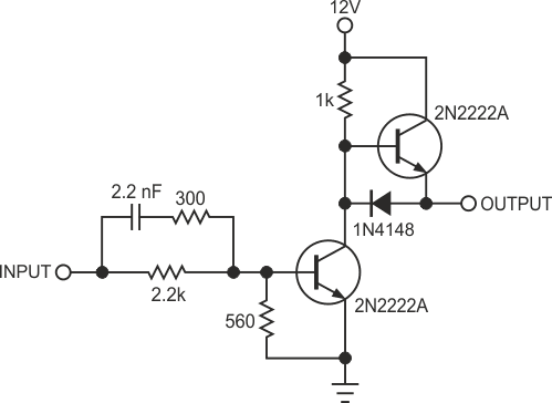

his buffer enhances speed at the PWM input of Figure 1's circuit.
Figure 2. his buffer enhances speed at the PWM input of Figure 1’s circuit.
The values are for a 370 W, three-phase inverter with 150% overload capacity. If you change the MOSFET, the value of C4 has to change according to the total gate charge plus the output capacitance of Q3, which is much lower and, in fact, negligible. Q1 amplifies the capacitor current, so C4 is proportional to QG2×hFE1. Make C4‘s value no higher than necessary, because the base current in Q1 would be too high. To obtain all the speed advantages of the circuit, the PWM signal should be able to quickly drive Q3. If necessary, you can use a buffer circuit (Figure 2). You can drive the circuit with a single CMOS gate. The circuit in Figure 1 is probably the simplest high-voltage inverter you can design. It has served in thousands of three-phase motor drives from 0.37 to 0.75 kW.
