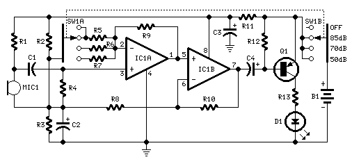

One LED monitors three levels: 50, 70 & 85 dB
Useful to detect too noisy environments
Circuit diagram:
Parts:
R1 |
10K 1/4W Resistor |
R2, R3 |
22K 1/4W Resistors |
R4 |
100K 1/4W Resistor |
R5, R9, R10 |
56K 1/4W Resistors |
R6 |
5K6 1/4W Resistor |
R7 |
560R 1/4W Resistor |
R8 |
2K2 1/4W Resistor |
R11 |
1K 1/4W Resistor |
R12 |
33K 1/4W Resistor |
R13 |
330R 1/4W Resistor |
C1 |
100nF 63V Polyester Capacitor |
C2 |
10µF 25V Electrolytic Capacitor |
C3 |
470µF 25V Electrolytic Capacitor |
C4 |
47µF 25V Electrolytic Capacitor |
D1 |
5mm. Red LED |
IC1 |
LM358 Low Power Dual Op-amp |
Q1 |
BC327 45V 800mA PNP Transistor |
MIC1 |
Miniature electret microphone |
SW1 |
2 poles 4 ways rotary switch |
B1 |
9V PP3 Battery |
Clip for PP3 Battery |
Device purpose:
This circuit is intended to signal, through a flashing LED, the exceeding of a fixed threshold in room noise, chosen from three fixed levels, namely 50, 70 & 85 dB. Two Op-amps provide the necessary circuit gain for sounds picked-up by a miniature electret microphone to drive a LED. With SW1 in the first position the circuit is off. Second, third and fourth positions power the circuit and set the input sensitivity threshold to 85, 70 & 50 dB respectively.
Current drawing is <1mA with LED off and 12-15mA when the LED is steady on.
Use:
- Place the small box containing the circuit in the room where you intend to measure ambient noise.
- The 50 dB setting is provided to monitor the noise in the bedroom at night. If the LED is steady on, or flashes bright often, then your bedroom is inadequate and too noisy for sleep.
- The 70 dB setting is for living-rooms. If this level is often exceeded during the day, your apartment is rather uncomfortable.
- If noise level is constantly over 85 dB, 8 hours a day, then you are living in a dangerous environment.
