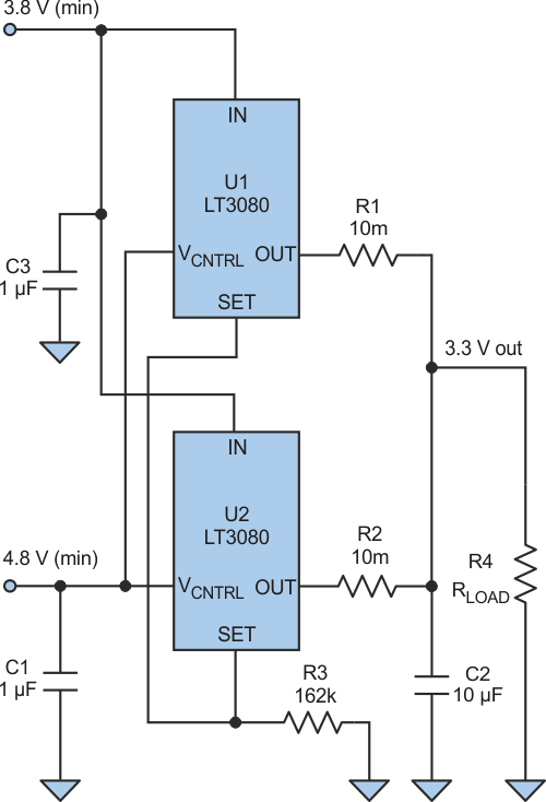

The data sheet for the LT3080 linear voltage regulator suggests using printed-circuit-board (PCB) traces for ballast resistors. Although the LT3080’s low offset voltage suits it well for this technique, it can be used for other ballast applications – for instance, for a set of bipolar transistors.
For example, in the Figure 1, ballast resistors R1 and R2 can be short lengths of copper trace. In a practical case, R1 and R2 can be about 5 mm (0.2 in.) long and just a few mils wide. Obviously, this is economical.
Although this circuit illustrates how copper PCB traces can be used as ballast resistors for the LT3080 linear voltage regulator, the technique is effective in other applications requiring ballast resistances.
Figure 1. Although this circuit illustrates how copper PCB traces can be used as ballast
Low-value current-sense resistors can be expensive, and using PCB copper for the resistors also saves the expense of mounting them while increasing reliability compared to soldered connections. The same benefits can be seen in other designs requiring low-value ballast resistors, and they may be a practical alternative to discrete parts even when the PCB traces take considerably more board area.
However, there’s an advantage to using PCB traces that’s not mentioned in the LT3080 data sheet. It involves the traces’ high temperature coefficient.
Using copper traces to sense and measure current may not be a good idea, because the resistance has a temperature coefficient of almost 0.4% per °C, which causes nearly a 10% change over 25 °C.
Although that’s a problem for precision measurement, it’s actually an advantage in ballast resistors, because the resistor carrying the highest current will show the largest self-heating (assuming the same environment for all the ballast resistors). That self-heating will increase the resistance, thus lowering the current in that branch compared to a branch that doesn’t self-heat as much.
For example, assume that the two regulators in the figure have output voltages that differ by 2 mV and the load current is 2 A. If R1 and R2 are each 10.00 mW, the higher voltage regulator will deliver 200 mA more current than the lower voltage regulator. But if R1 and R2 are narrow traces that self-heat at 2.5 °C/mW, with 10-mW resistance at the board’s nominal operating temperature, the current difference between the two regulators will be approximately 150 mA, or 25% less than if the circuit used temperature-stable resistors for R1 and R2.
The LT3080 data sheet mentions that you can distribute these regulators around a board. They don’t have to be close together to share current between two regulators. That’s an obvious advantage to distributing heat around your board. However, it also suggests an additional advantage you can obtain from the temperature coefficient of resistance of copper ballast resistances.
You’re probably more interested in the temperature of the regulator than the actual current sharing. Consequently, you can opt to lay the board out so that R1 picks up the thermal rise of U1. On top of that, you can also have R2 sense the temperature of U2.
Particularly for a multi-layer board, you can put the ballast resistors on the layer immediately below the regulator and pick up a big percentage of the temperature rise caused by the regulator. And, you can make the ballast resistance traces relatively large so that their self-heating is small and their thermal rise is mostly caused by picking up the rise from the nearby regulator.
Thus, you can see that when it comes to ballasting, the high temperature coefficient of resistance of copper trace is an advantage, not a liability.
