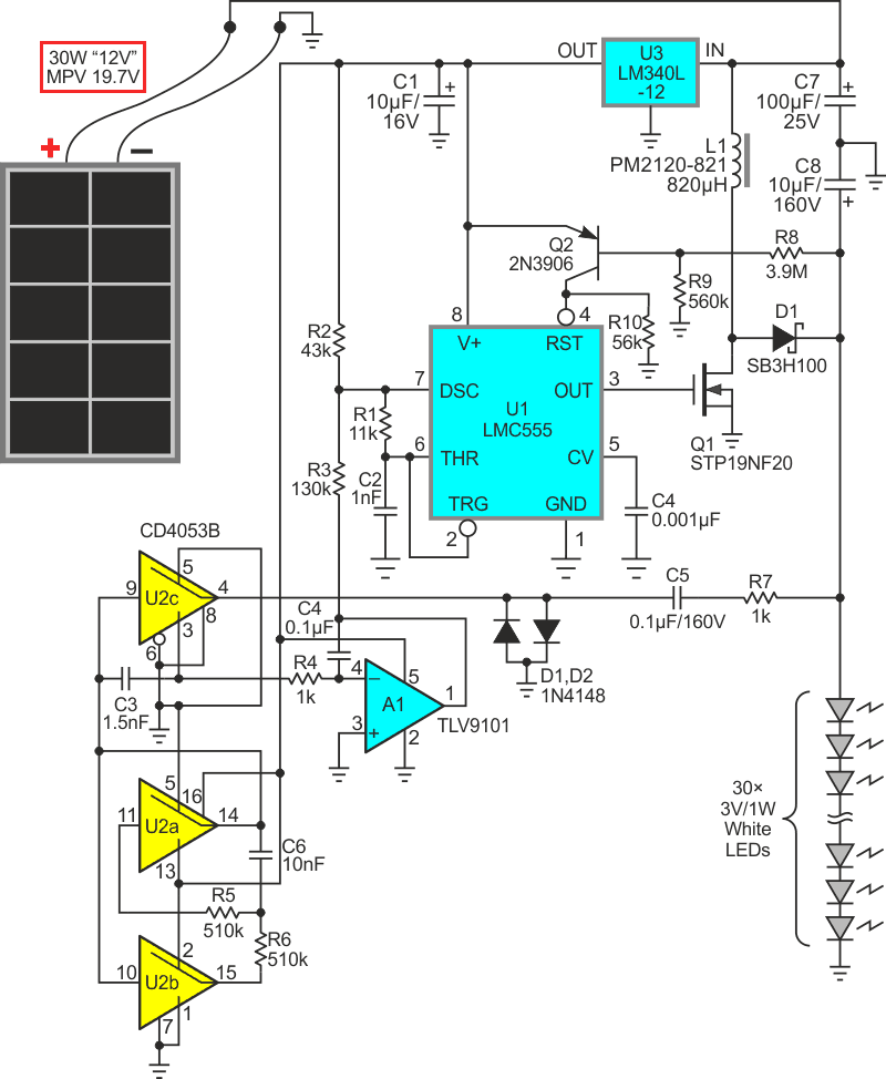

For such a double-conversion scheme, converting light into electricity and then back into light, to work with a reasonable size (and cost!) solar panel and still be bright enough to be useful, puts a premium on achieving high efficiency for both conversion steps. This design idea (see the Figure 1) presents some ways to achieve these design imperatives.
| Figure 1. | Solar day lamp with maximum power point tracking and high voltage, constant-current LED drive. |

In order to extract maximum power from the panel, optimum loading must vary with incident illumination and temperature. This stratagem is typically called maximum power point tracking (MPPT) and is the purpose of U2, A1 and surrounding components.
U2a and U2b oscillate to generate a ~100 Hz “perturbation” square-wave that is summed with the duty-cycle control signal applied to U1. This results in periodic variation of the solar panel loading voltage. Panel power efficiency therefore also varies, generating a signal at synchronous rectifier U2c pin 4, where it is sampled and applied to feedback integrator A1. The resulting MPPT signal is accumulated, becoming feedback to 25 kHz voltage-multiplier oscillator U1 that increases or decreases U1’s duty cycle in the correct direction to maximize power accepted from the solar panel.
A generalized description of how “perturb-and-observe” active MPPT works is detailed in “Solar-array controller needs no multiplier to maximize power” (Ref. 1).
The power extracted from the panel must then, of course, be input to the LED array and used to generate useful light. The usual way this is usually done is to connect the LEDs in a low voltage serial/parallel matrix. This topology unfortunately incurs inherent inefficiency due to the need for current-balancing ballast resistors that compensate for unavoidable mismatch between LED forward voltages. About 10% or more of total available power is typically lost in this way.
The circuitry shown avoids this inefficiency by boosting panel voltage to a value high enough (~90 V) to accommodate a pure series connection of thirty1-W LEDs. Hence the need for ballast resistors is eliminated along with their undesirable power losses, resulting in a significant further improvement in lamp efficiency.
A complication arises, however. What if continuity of the LED series string is lost and the current delivered by D1 has nowhere to go?
If this should happen and nothing were provided to safely control the accumulation of charge on C8, the voltage there would rise dangerously (theoretically without limit) until destruction, perhaps violent, of many components including Q1, D1, and C8, became inevitable. Voltage comparator transistor Q2 is configured to prevent this catastrophe, setting U1’s RESET input low and shutting down Q1 drive should a hazardous overvoltage condition threaten to occur.
