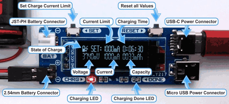

TinyCharger is an ATtiny25/45/85-based, single-cell Li-ion battery charger with selectable charging current limit (100 mA - 1000 mA) and an OLED display for monitoring.
For Power Connecting device is equipped with a Micro-USB and a USB-C connector for power supply. Only one connector can be used at a time. The supply voltage must be 5 V. For Battery Connecting device is equipped with a JST-PH 2.0 mm socket and a 2.54 mm pin header for connection to the battery. Only one battery can be charged at a time (Figure 1).
TinyCharger - Single Cell Li-Ion Battery Charger with Monitoring.
Figure 1. TinyCharger - Single Cell Li-Ion Battery Charger with Monitoring.

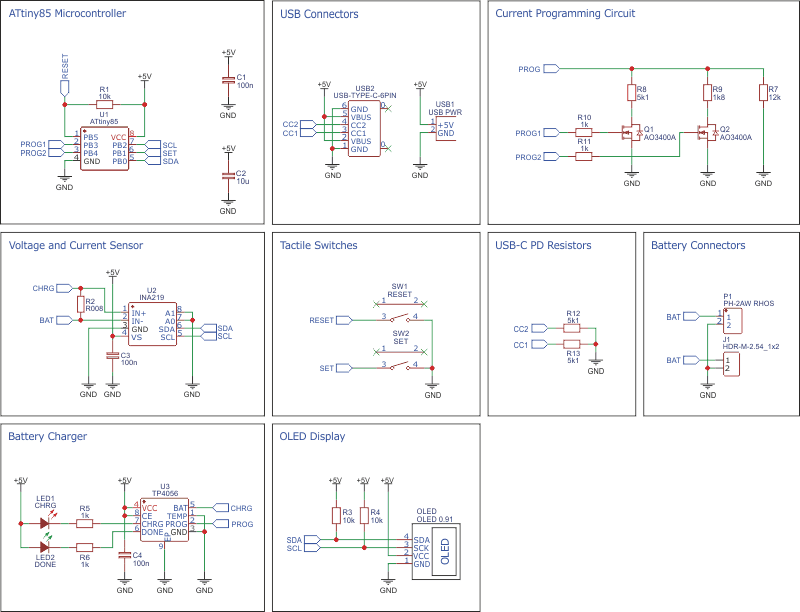

For battery charging the TP4056 is used (Figure 2). The TP4056 is a complete constant-current/constant-voltage linear charger for single-cell lithium-ion batteries. The maximum charge voltage is fixed at 4.2 V and the charge current can be programmed externally with a resistor. The total resistance is determined by three resistors connected in parallel, two of which can be switched on and off by the ATtiny via MOSFETs. The TP4056 automatically terminates the charge cycle when the charge current drops to 1/10th the programmed value after the final float voltage is reached. Other features include current monitor, under voltage lockout and automatic recharge.
TinyCharger Schematic Diagram.
Figure 2. TinyCharger Schematic Diagram.
An INA219 is used to measure voltage and current. The INA219 is a current shunt and power monitor with an I2C-compatible interface. The device monitors both shunt voltage drop and bus supply voltage, with programmable conversion times and filtering. A programmable calibration value, combined with an internal multiplier, enables direct readouts of current in amperes. The selected shunt resistance of 8 milliohms enables both a very small influence on the circuit and a measurement with a resolution of 1 milliampere. For an accurate measurement, a shunt resistor with a low tolerance (1% or better) should be selected.
All project files available in download section, in project page on Github.com [1] and in EasyEDA [2].
The user interface utilizes two buttons and a 128×64 pixels OLED display. An ATtiny25/45/85 microcontroller handles the user interface as well as the control and monitoring of the charging functions (Figure 3).
TinyCharger PCB view (bottom layer).
Figure 3. TinyCharger PCB view (bottom layer).
Connectors and buttons description shown on Figure 4.
TinyCharger user interface description.
Figure 4. TinyCharger user interface description.
The charging current is programmed via a resistor, the value of which can be set by the ATtiny via two MOSFETs and changed by pressing the SET button. An INA219 continuously measures the charging current and voltage and transmits the values to the ATtiny via I2C. From this, the ATtiny calculates the state of charge and capacity and displays the values on the OLED screen.

Connect the device via the Micro-USB or USB-C port to a 5 V power supply that can provide sufficient current. Use the SET button to select the maximum charging current. Note that it can overshoot by a few milliamperes!
Connect the Li-Ion battery to one of the battery connectors. Pay attention to the correct polarity!
The battery is charged immediately. The SET button is locked during the charging process to prevent the charging current from being changed accidentally. The charging process stops automatically when the battery is fully charged. The total charging time and the charged capacity remain displayed as long as the device is supplied with power. These values can be reset using the RESET button.
