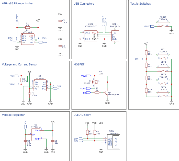

An INA219 is used to measure voltage and current (Figure 2). The INA219 is a current shunt and power monitor with an I2C-compatible interface. The device monitors both shunt voltage drop and bus supply voltage, with programmable conversion times and filtering. A programmable calibration value, combined with an internal multiplier, enables direct readouts of current in amperes. The selected shunt resistance of 8 milliohms enables both a very small influence on the circuit and a measurement with a resolution of 1 milliampere. For an accurate measurement, a shunt resistor with a low tolerance (1% or better) should be selected.
USB Phone Charge Guard schematic diagram
Figure 2. USB Phone Charge Guard schematic diagram
The device is supplied with 3.3 V via an HT7333 LDO voltage regulator, which taps the input voltage of up to 12 V from the USB bus power.
The connection between the power supply and the phone is switched on and off via an AS3621 P-channel MOSFET. Despite its small size, it can switch up to 30 V with 6 A continuously. Its internal on-resistance is only about 20 milliohms.

The INA219 continuously measures current and voltage and transmits the values to the ATtiny via I2C. From this, the ATtiny calculates the other values and displays them on the OLED screen. It controls the connection between the power supply and the phone via the MOSFET depending on the settings chosen by the user. The user settings are saved in the EEPROM and automatically loaded the next time it is used.
