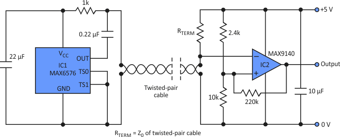

Figure 1 shows a simple and economical interface for remote IC thermal sensors. IC1, a MAX6576, is an absolute temperature-to-period converter that integrates a sensor with the necessary signal electronics. It connects to the receiver (a simple comparator) using a twisted-pair cable that simultaneously carries power to the sensor and signals from the sensor.
At the receiving end, you can recover the temperature data from the comparator-output pulses with a simple timer/ counter routine executed by a microcontroller. Or, in analog form, you can use a constant-slope, linear saw-tooth generator synchronized with the received pulses, followed by a peak sample/hold (S/H) converter.

With its TS0 and TS1 terminals connected, the MAX6576 exhibits a digitizing conversion constant of 10 µs/K (Fig. 1). So at room temperature (300 K), the output pulse period should be 3000 µs (3 ms), which corresponds to a repetition rate of about 333 Hz. Figure 2 shows this to be the case, even with a 1000-m (approximately 3300-ft) cable. Similar results were obtained using a 60-cm (2-ft) cable. Figure 3 shows the receiver's input pulses using the 1000-m twisted-pair cable. The timing results were similar to those measured using the 60-cm cable.

Measurements of the receiver's pulse-to-pulse output jitter (where total measurement error is the ratio of jitter to the signal period) indicate that the jitter influence is negligible, even with the long cable. This transmission scheme can also be used with temperature-to-frequency converters and other sensors.
