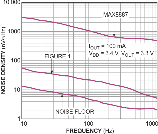

A noise-density-versus-frequency plot for the lowdropout circuit in Figure 1 is 38 dB lower than that of a conventional low-noise, low-dropout-voltage regulator - in this case, a Maxim MAX8887.
Figure 3. A noise-density-versus-frequency plot for the lowdropout circuit in
low-dropout-voltage regulator – in this case, a Maxim MAX8887.
Figure 3 shows a plot of noise density versus frequency for the circuit of Figure 1, which exhibits a noise floor of about 6 nV/√Hz at 1 kHz. For comparison, the plot shows the noise-measurement instrument's noise floor and a typical low-dropout circuit's much higher noise density – for example, 500 nV/√Hz at 1 kHz for the MAX8887 low-noise, low-dropout circuit.
