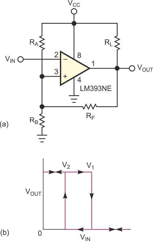

For an inverting amplifier with hysteresis, resistors RA, RB, and RF determine the crossover voltages (Figure 1). Unfortunately, using three resistors to set the upper and lower trip voltages creates a dependence between the two trip voltages: It’s impossible to set one voltage without affecting the other. However, you can achieve the same output-voltage response with two independent trip voltages by using a comparator with an open-collector output, such as the LM393 or LM339. In Figure 2, the resistor divider of R1, R2, and R3 determines the upper trip voltage, V1. R4 and R5 determine the lower trip voltage, V2.
Three resistors determine the trip voltages of an inverting comparator (a) with hysteresis (b), but the trip voltages are not independent.
Figure 1. Three resistors determine the trip voltages of an inverting
