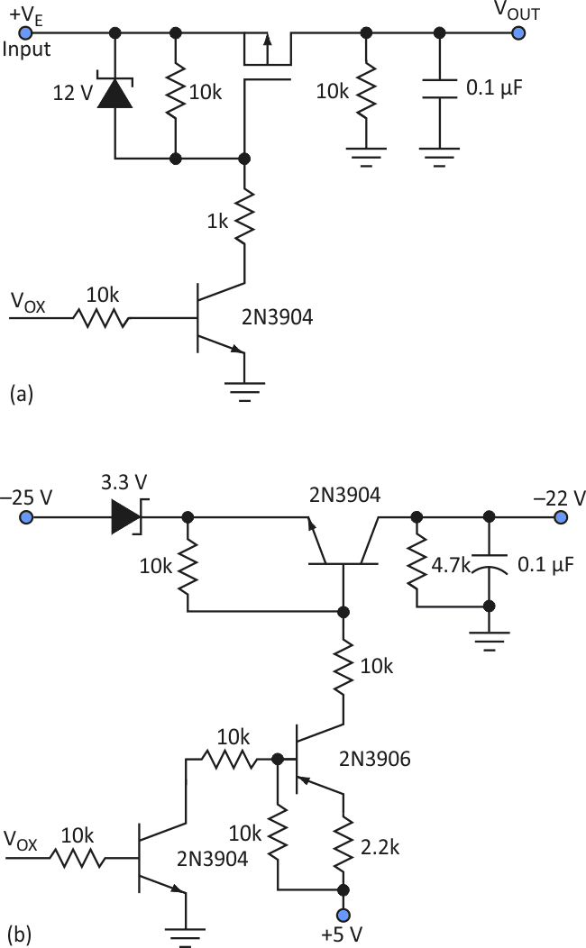

The EN signal should appear only after the LCD controller is initialized and the signals are active. (EN can also be connected to VSYNC, so that when the LCD controller is initialized, LCD power is auto-enabled.) One STN passive-type LCD requires the power-on sequence to be: VCC, then LCD data/control signals, then 22-V bias (with greater than 20 ms delay in between). In this example, V1 controls VCC to the LCD using a positive voltage switch (Fig. 2a), V2 controls the bus switch, and V3 controls the 22-V bias using the negative voltage switch (Fig. 2b). The negative switch is designed specifically for 22-V bias switching. The MOSFET in the positive switch should have a logic-level threshold. Both switches use active-high power Enable signals.
V1 controls VCC to the LCD through the positive voltage switch (a), while V3 controls the -22-V bias through the negative control switch (b).
Figure 2. V1 controls VCC to the LCD through the positive voltage switch (a), while
V3 controls the –22-V bias through the negative control switch (b).

Note that by adjusting the time constants, the 22-V bias is enabled only when power and data signals are applied, and data signals are enabled only after VCC is applied. The resistance could be 10 to 47 kΩ, and the capacitors can be 0.1 to 0.47 µF, X7R types.
