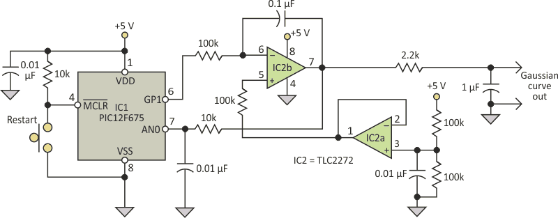

The simple microcontroller circuit (Fig. 1) generates an analog Gaussian curve without needing a DAC. The key to the design is that most microcontrollers allow their I/O pins to be dynamically reconfigured to function as either a high-impedance input, or as an output. The analog core of the circuit is an operational amplifier integrator (IC2b) whose reference voltage is set at half the supply voltage by the other half (IC2a) of a dual package.
The Gaussian curve generator circuit takes advantage of dynamic reassignment functionality of a microcontroller's I/O pin, operating in coordination with an op amp functioning as an integrator.
Figure 1. The Gaussian curve generator circuit takes advantage of dynamic reassignment functionality of a microcontroller's
When microcontroller output (GP1) is in its high-impedance state, integrator IC2b neither charges nor discharges, so the output voltage is constant. When the output voltage as read by the microcontroller's analog input (AN0) shows that more output voltage is required, the software sets GP1 to its low-voltage state, so the integrator will charge.

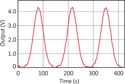

When too high a voltage is sensed, GP1 is set to its high-voltage state, and the integrator will discharge. The program, listing of which is given in the Downloads section, is designed so that this servo loop is damped to prevent excessive "seeking" around the setpoint voltage, as is shown in the output (Fig. 2).

Figure 2. The noise, as seen in this "strip chart" trace of the circuit,
output mimics a typical data signal.
Rail-to-rail op amps, like the one used in this circuit, don't function well with signals near the rails, so getting a true zero-voltage signal isn't possible with a unipolar supply. Bench measurements on the circuit show a minimum voltage of about 30 mV when driving a high-impedance load. Also, this approach to voltage generation won't work for rapidly-changing signals. For the 4-MHz processor used, two updates per second are about the limit.
