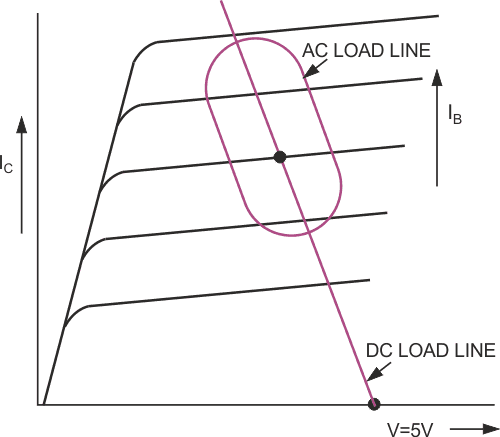

One SO application area is the conversion of audio and video to FM in a single process. Figure 1 shows a simple, one-stage SO oscillating at 94 MHz. This frequency is a good choice for testing the audio-to-FM conversion on an FM broadcast receiver. The audio or video input to this SO should not exceed –5 dBm; any signal above this level may induce amplitude modulation. C4’s decoupling capacitor passes the audio or video to the SO and eliminates dc bias at the input. R1 biases the SO. Because the oscillator's load is a combination of resistance, inductance, and capacitance, the load line is a combination of a straight line and an ellipse (Figure 2). The linear load line indicates the dc bias, and you must locate the load line away from the nonlinear characteristics of the transistor.
The load line is a combination of a straight line and an ellipse.
Figure 2. The load line is a combination of a straight line and an ellipse.
