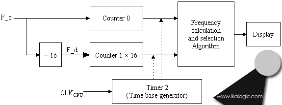

The maximum frequency that can be sampled by one of the counters of the ATMEGA16 cannot exceed the CPU clock divided by 2.5. Let's call this frequency Fmax. So, assuming the ATMEGA16's CPU is clocked at 8 MHz, we can directly measure frequencies up to 3.2 Mhz. Frequencies above that limit will be measured as 3.2 MHz or less, since not all the pulses will be sampled. To be able to measure frequencies above F_max, we use a 4 bit counter as a frequency divider, dividing the measured frequency by 16. This way we can also measure frequencies up to 16 times Fmax, but due to the limitation of the 74HC191 counter, the actual maximum measurable frequency wont exceed 40 MHz.
The algorithm that we developed measures both the original frequency (let's call it F_o) and divided frequency (F_d). in normal conditions, when the frequency is below F_max, the following relation is true:
Fo=16×Fd;
But as F_o approaches to F_max, more and more pulses wont be sampled, and the the relation above will obviously become:
Fo<16×Fd;
And hence the limit of the microcontroller can be automatically detected.
The frequency meter starts by selecting the original frequency for processing and display, and as soon as it detects that it reaches F_max (using the method described above), the divided frequency is selected instead.
This algorithm can be summarized in the following flow chart (figure 3)
Figure 3
