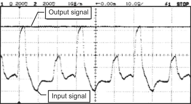

In this design, the measured peak voltage should be 0 to 2.5 V. The detector’s accuracy depends on the pulse duration and duty cycle. For example, 1 V rectangular pulses having 3-nsec duration and 5% duty cycle produce 5%-low readings. Similar inaccuracy occurs for 10-nsec pulses having 0.1% duty cycle. The accuracy is much better for longer pulse durations, greater duty cycles, or both. The circuit measures pulses lasting for some tens of nanoseconds and having repetition frequency of approximately 1 MHz. To deal with pulses having a lower repetition rate, you should increase the values of C1 and C2. That increase would, however, result in longer settling time. Another important element is the discharging resistor, R1. A value of 100 kΩ for R1 is appropriate for operation with low-duty-cycle pulses, but you may need lower values for fast tracking with varying input-signal amplitudes. You can also configure a minimum-value peak detector. In this case, you should use the inverting output of the comparator and also reconfigure the amplifier/shifter for inverting operation. Figure 2 shows an example of the circuit’s operation. The circuit correctly measures the peak value of the applied input signal, although the input pulses are quite short and have nearly triangular tips.
The circuit in Figure 1 yields a dc value equal to the positive peak of the input signal.
Figure 2. The circuit in Figure 1 yields a dc value equal to the positive peak
