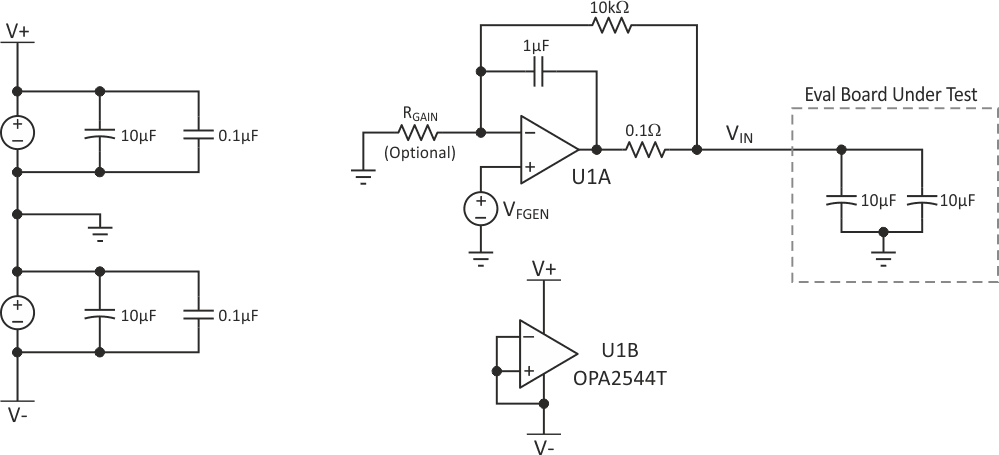

After several failed attempts at rigging up a solution with a function generator in series with a power supply, I came up with the circuit shown in Figure 1. This circuit itself is the product of several revisions of tinkering on the bench to see what worked best. In a nutshell, the desired voltage transient is created on a function generator and buffered using a high power op-amp to drive the 20 µF of capacitance on the evaluation board.
| Figure 1. | Line transient tester schematic. |
The heart of this circuit is an OPA2544T from Burr-Brown/Texas Instruments, which is capable of operating from ±35 V supplies and outputting up to 6 A of current if proper precautions are taken. Although this particular application didn’t call for quite so much power, choosing an amplifier that exceeded my immediate needs allowed for a more general test fixture to be built. Once my validation work was completed, this circuit could be used to test many different regulators, battery chargers, and other circuits with a wide range of input capacitance.
The 0.1 Ω resistor between the output of the op-amp and VIN is in place to prevent excessive ringing when recreating fast pulses from the function generator. This resistor is also the output impedance of the circuit over a wide range of frequencies when the load capacitance is rather large, as is the case here [1]. RGAIN can be added to the circuit to allow for voltage transients outside the range of the function generator (±10 V in my case). Putting a minimum resistor in series with a potentiometer for RGAIN is recommended in order to keep the output from saturating should the potentiometer be set incorrectly.

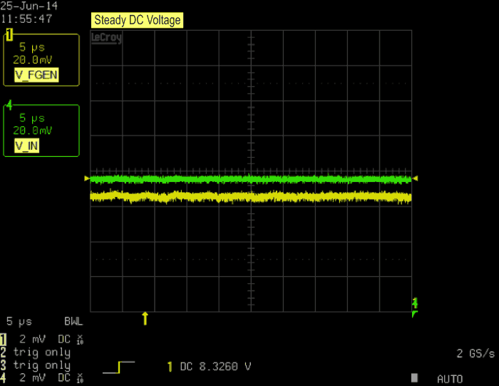

Figure 2 shows the circuit prototyped using copperclad scored with a hobby knife, plus whatever passives I had on hand at my bench. During proof-of-concept testing, a stand-in board was used, with the same 10 µF input capacitors as the real application mounted on a second piece of copperclad. The amount of power drawn by the chip under test was considered negligible and thus ignored at this stage. function generator, as well as between the transient circuit and the input capacitors (note the cut down BNC cable on the left and the copper strips at the bottom). The 0.1 Ω resistance is made from two 0.2 Ω power resistors in parallel to make sure there isn’t any issue carrying high current. While I was feeling out the performance of this circuit I found under certain slew conditions it could become quite warm, so if this ever gets made into a proper circuit board, a heat sink would be a welcome addition. As another general tip, I found the best performance was obtained with at least 6 V of supply headroom on the op-amp relative to the highest or lowest voltage expected (Figure 3).
| Figure 3. | Providing a DC voltage. |

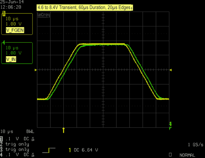

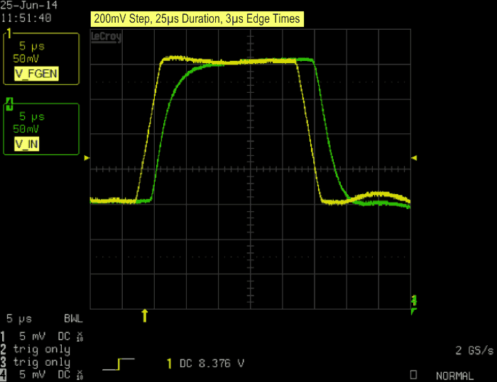

Figures 4 and 5 show the performance of the transient circuit under small, fast line steps and large, slow transients. While not perfect for very fast transients, the prototype performed more than adequately for testing the self-recovery function of the IC. The lack of ringing on either edge meant no false triggers occurred in the chip, I was able to successfully complete the required validation in time to make my deadline, and there was much rejoicing. For recreating larger, slower waveforms from the function generator, the results were even better, showing a stable, though slightly over-damped system.
| Figure 4. | Small, fast edge transient results. |

| Figure 5. | Large, slow edge transient results. |
