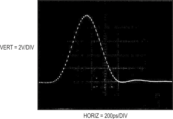

The regulator’s 90 V output is applied to Q1 via the R3-C1 combination. Q1, a 40 V breakdown device, non-destructively avalanches when C1 charges high enough. The result is a quickly rising, very fast pulse across R4, C1 discharges, Q1’s collector voltage falls and breakdown ceases. C1 then recharges until breakdown again occurs. This action causes free-running oscillation at about 200 kHz. Figure 2 shows the output pulse. A 1 GHz sampling oscilloscope (Tektronix 556 with 1S1 sampling plug-in) measures the pulse at 10 V high with about a 1 ns base. Rise time is 350 ps, with fall time also indicating 350 ps. The figures may actually be faster, as the 1S1 is specified with a 350 ps rise time limit.
| Figure 2. | Avalanche pulse generator output pulse. waveform has 350 ps rise and fall times. Slightly under damped turn-off is probably due to test fixture limitations. |

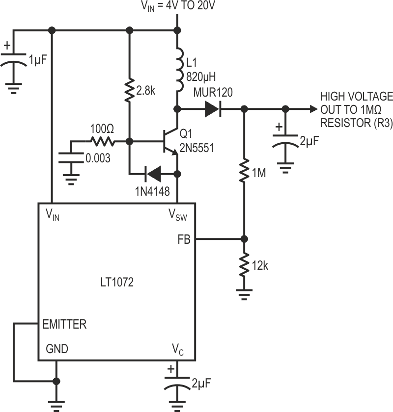

| Figure 3. | Alternate 90 V DC-DC converter. |
For those applications which must run from higher voltage inputs, Figure 3 is included. This circuit, which operates from inputs of 4 V to 20 V will also power the avalanche stage. Cascoded high voltage transistor Q1 combines with the LT1072 switching regulator to form a high voltage switched mode control loop. The LT1072 pulse width modulates Q1 at its 40 kHz clock rate. L1’s inductive events are rectified and stored in the 2 µF output capacitor. The 1 MΩ to 12 kΩ divider provides feedback to the LT1072. The diode and RC at Q1 ’s base damp inductor related parasitic behavior. The circuit’s output drives the avalanche stage in similar fashion to the LT1073 based circuit.
